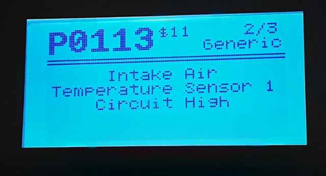

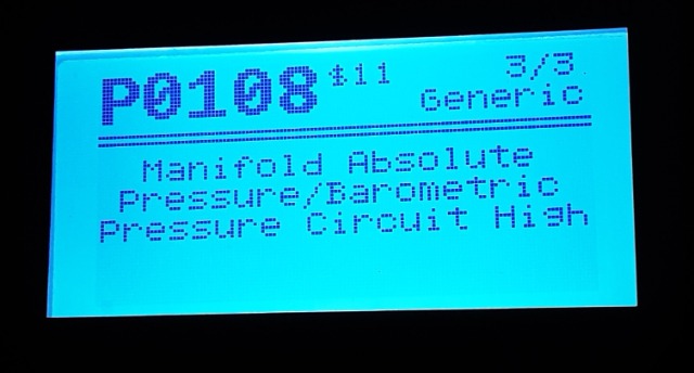

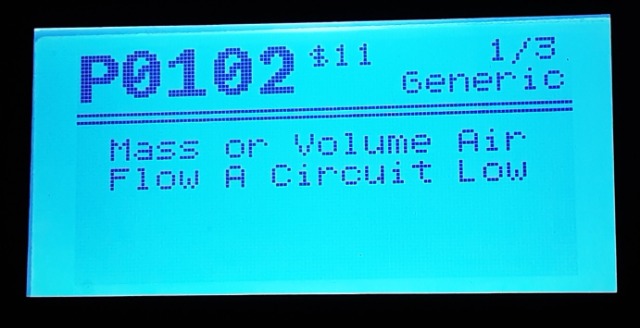

27 Nov 2021 16:23 - 27 Nov 2021 16:24 #240355
by HUN
TrailMaster 2" lift kit
ORE transfer box HD brackets
T-Max split charge system
Flo-Flex castor polybushes
Kumho KL71 tyres
AVM manual hubs
ORA radius arm guards
Push-fit breathers
Replied by HUN on topic Correct Lamda Sensor for a 2005 VVT M13A Jimny
I have fiddled with the connectors, unplugging then plugging back, checked air filter etc. Did all this very carefully so nothing got damaged. I'm not sure whether this has triggered the sensors or not but 'managed' to create three DTCs...at least I have something this time!
