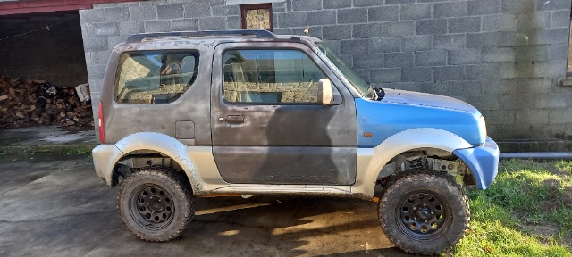

Didn't get out for a spin today was just picking my way through odds and ends. Bumper, wheel arches, replacement bulbs, new radio aerial . ........
