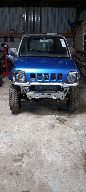

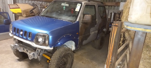

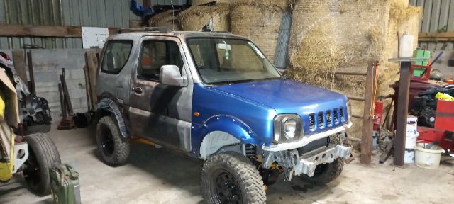

08 Jan 2022 20:48 - 08 Jan 2022 20:53 #240980
by Dirtbird
Replied by Dirtbird on topic BODY SWAP a 2004 M13A onto a 1999 G13BB chassis
Last edit: 08 Jan 2022 20:53 by Dirtbird.
- Posts: 9908
- Thank you received: 1983
09 Jan 2022 06:47 #240984
Replied by Lambert on topic BODY SWAP a 2004 M13A onto a 1999 G13BB chassis
Looking good, the hard work is paying off!
- Dirtbird
09 Jan 2022 20:05 #241003
by Dirtbird
Riccy
I found the cap for the charcoal thingy thanks man. Ok re the breathers dont have lockers in the diffs so hope to get away with it. Thanks Riccy.
