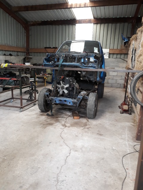

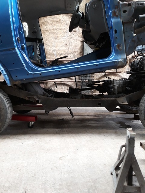

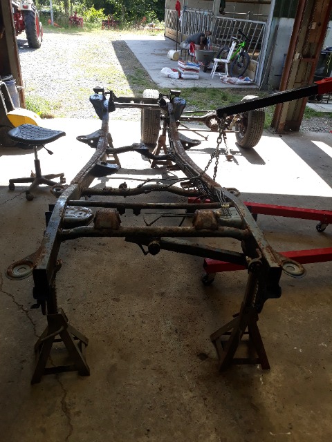

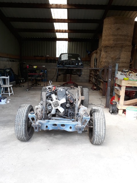

Now facing into the reconstruction cant decide what to do with the chassis after I clean it. I'll make up my mind soon enough.

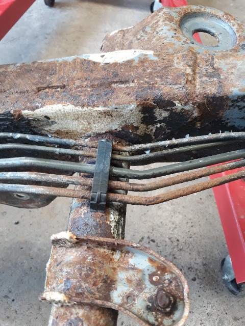

24 Jul 2021 17:49 #236931
by facade
Replied by facade on topic BODY SWAP a 2004 M13A onto a 1999 G13BB chassis

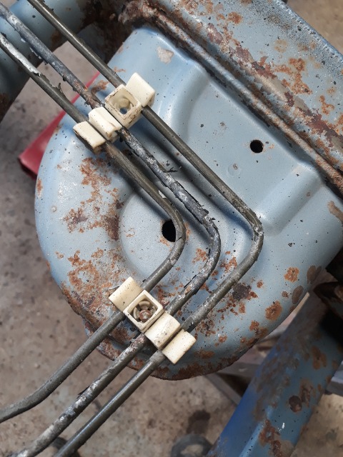

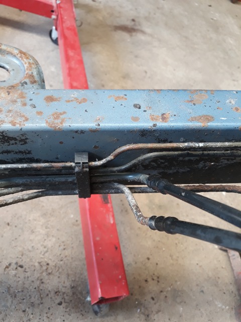

When I did my fuel & brake lines I had this idea that I could open them up and get the pipes out- they are too brittle. I ended up cutting the pipes into small sections and sliding them out one at a time (along the pipe, not across it). The clips did click over the new pipe though- mostly.
Going to need some advice on how to open and remove these black clips that hold the fuel and brake lines together I want to reuse them .
