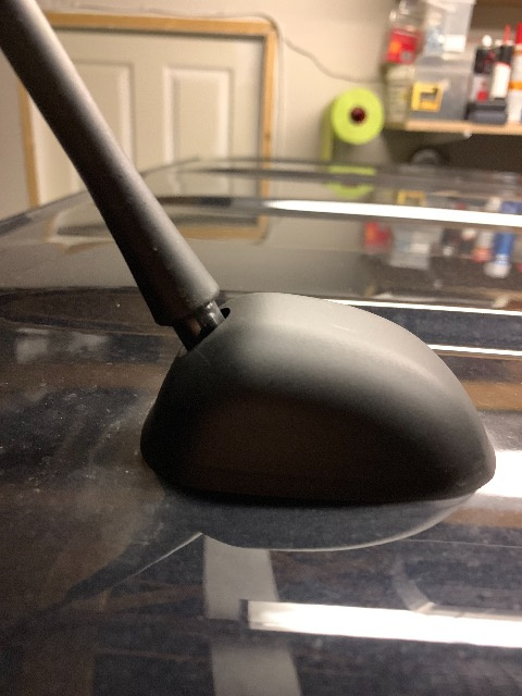

I hope you can find one. I have a shorter whip antenna fitted at the moment but because the standard screw fitting is so recessed inside the antenna, I couldn’t find an exact match, so it looks like it hasn’t been screwed on properly!
Would love to refit the original at a more reclined angle.

Pic? Is it so much, a single o-ring or two wont cover?

Oh, like that. Hard to get that pretty. Does the original antenna seal the hole, so no water gets into the unit?

I think so but I haven’t properly checked that yet. Another reason to change it.

With any mounted aerial such as that, you could always do what we do on aircraft aerials, and that is, mask-off around the base of the fitted aerial with some decent tape such as Frog Tape and seal the joint with Polyurethane sealant
You can find it cheaper than that illustration on places like Amazon. I've used it to bond aluminium strengthening plates to the mounting points on aluminium vintage car mudguards.
Don't be tempted to use silicone sealant - it gives up the ghost after a while.
