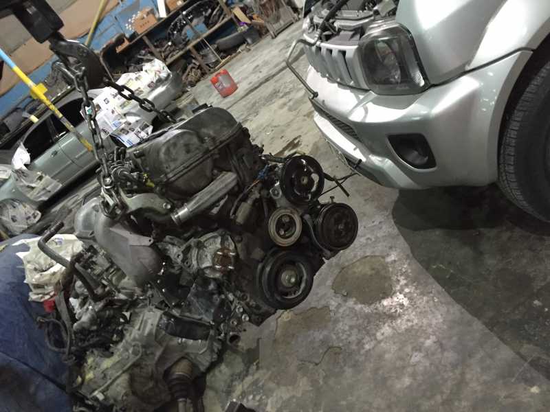

i have automatic trans

The engine run great
and there is no check engine
I went to the desert yesterday
every thing is ok
every thing is ok

Nice you must be loving the lower end torqueMr.m.y wrote: The engine run great
every thing is ok

Hi,
Do you modified wiring when convert from m13a to m18a, have you've done any ecu tuning.
I just buy 2015 jimny 1.3 non vvt & i am planning to swap the small engine.
