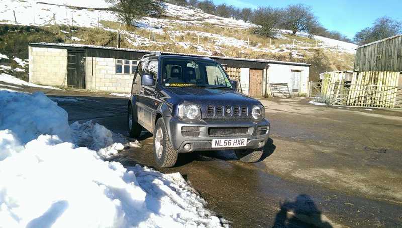

- hannah-jg
28 Sep 2015 12:54 #152669
by hannah-jg
Replied by hannah-jg on topic Tyre Sizes - Rough Guide Thread
- Langdonm
02 Oct 2015 20:59 #152887
by Langdonm
Replied by Langdonm on topic Tyre Sizes - Rough Guide Thread
If bought 265/75/r16
Guessing I've got no chance with no lift then ?
Would they fit if the arches and bumper were cut ?
