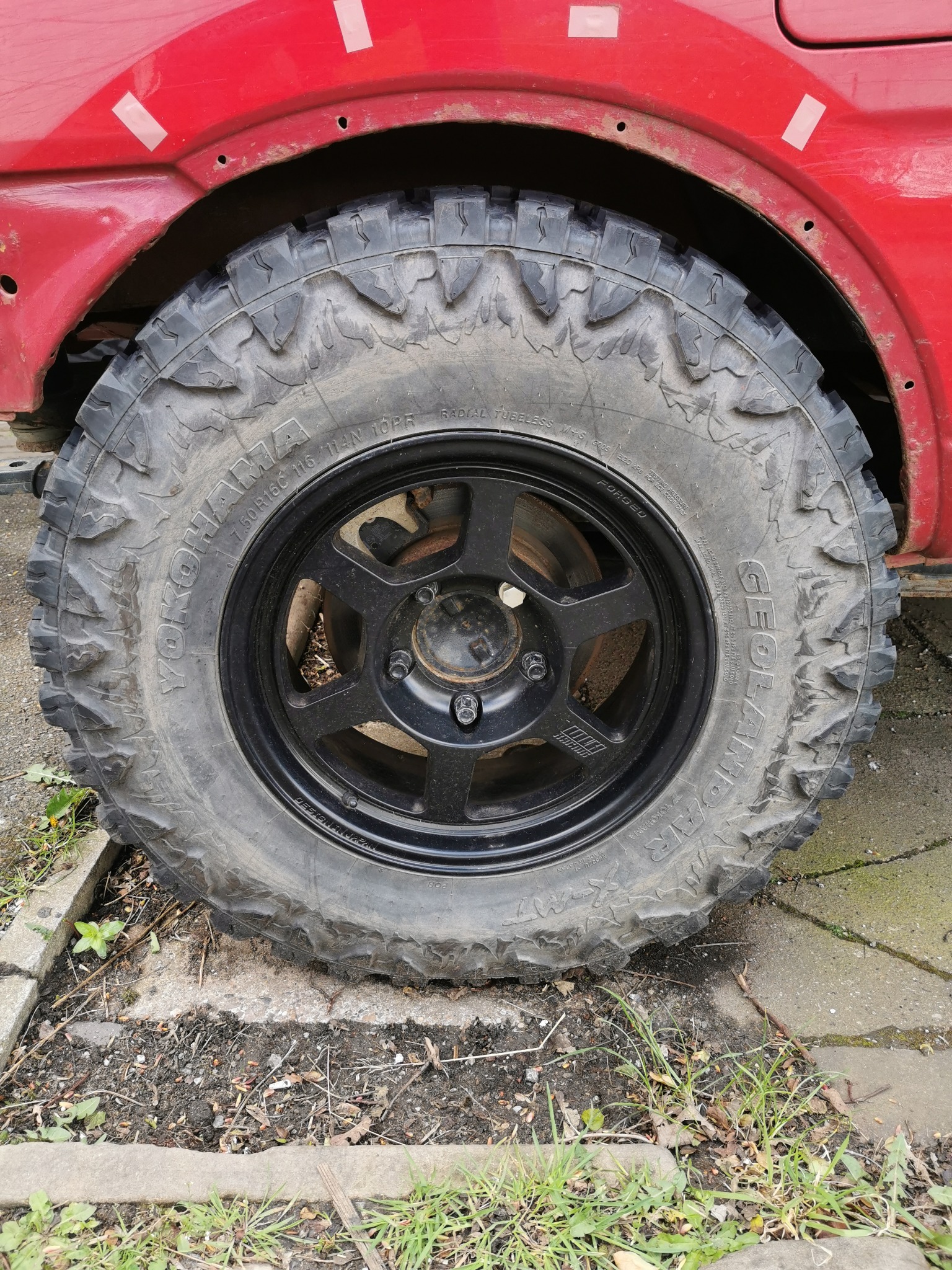

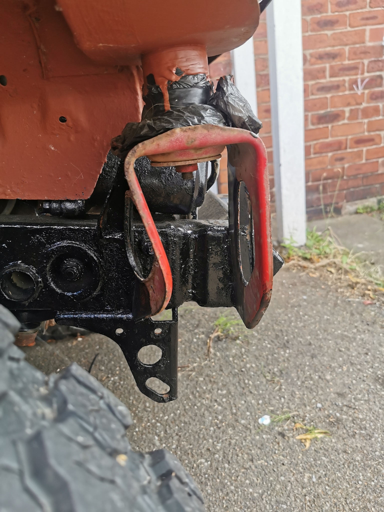

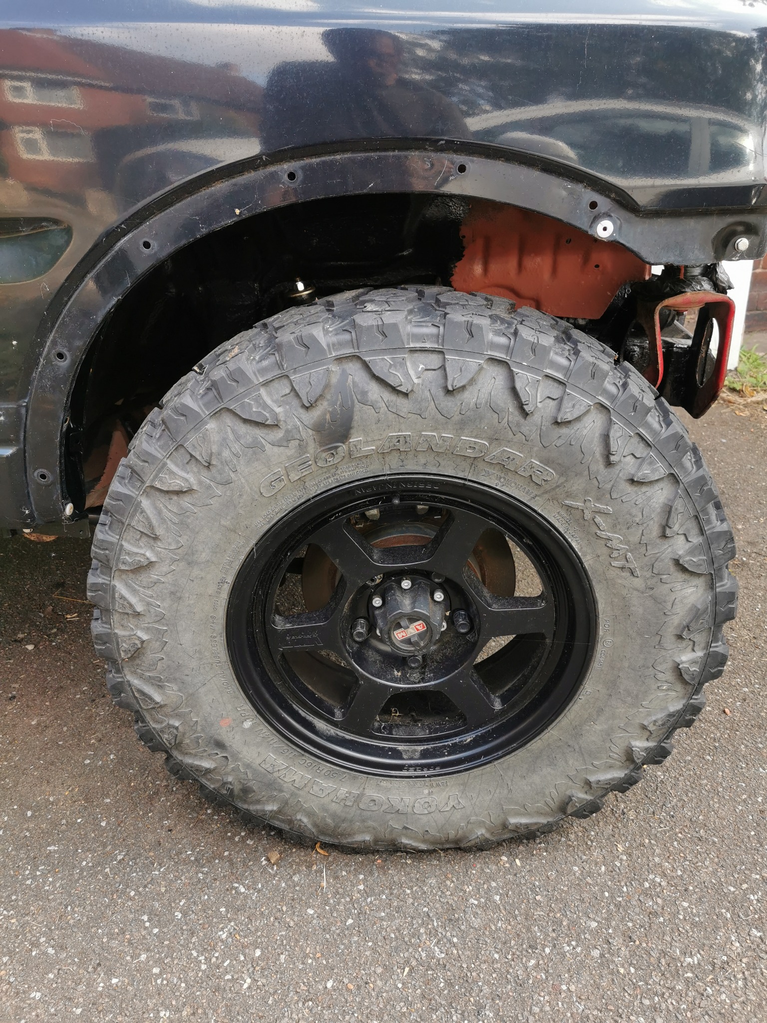

This spot could be the source of the rubbing
Chassis front body mounts see how I have bent it forwards.
This is a picture of my 32" tyre on a 2" lift with JB23 wings
0 off set
Has for reference my wheel base is 2273mm standard is 2250
I have gained the extra length because I have front and rear +3" radius arms fitted
The last picture is when my rear spring broke and is sitting on the bump stop
I have front and rear +2“ extended bump stops
0 off set

Replied by iac27 on topic Tyre Sizes - Rough Guide Thread
Thanks for the suggestion. I had a Quick Look and it doesn't show in signs of rubbing there.
