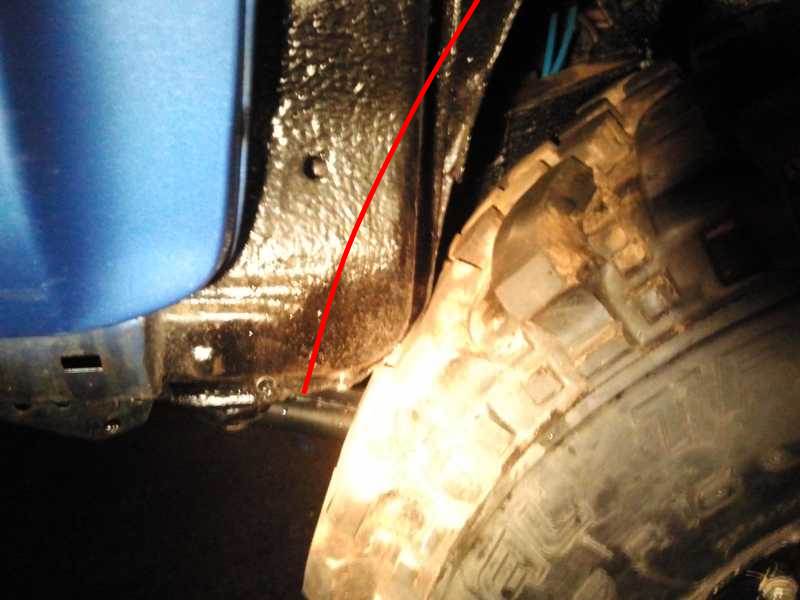

Here's roughly how much I have cut it so far.
EDIT: Actually only about a half of that is cut off, and the rest I have just smashed in with a hammer. :laugh:
