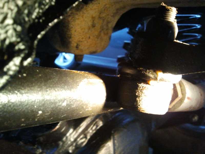

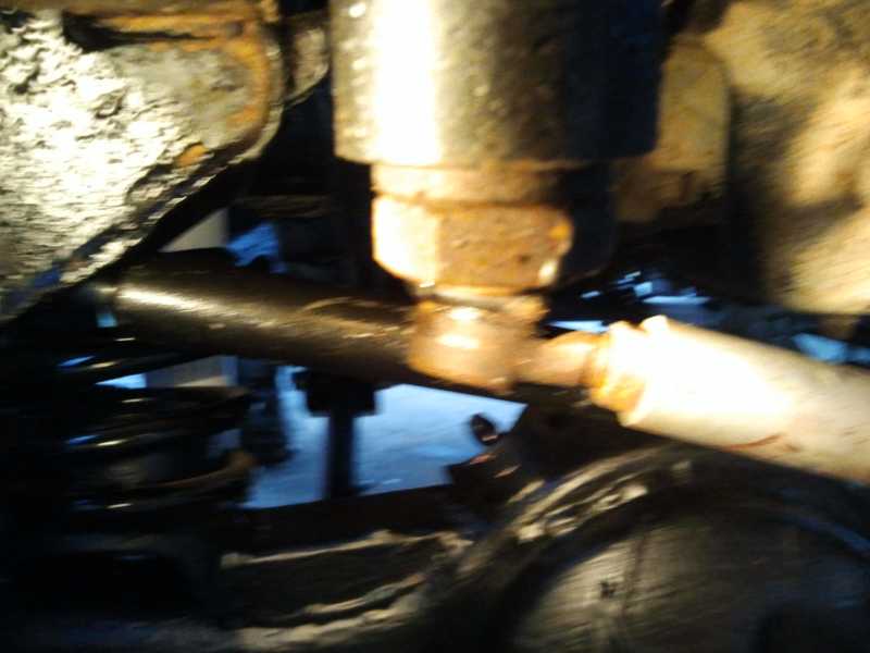

Ive just been out to look at it again and I think I will do some cutting of the arch before moving/extending the radius arms. I think the moving/extending action will make worse the steering arm/panhard fouling problem worse and I still haven't sorted that one yet :)

  • panosd
18 Oct 2012 16:40 #50714 by panosd
Replied by panosd on topic 33s Rubbing
Why your panar is sssooooooo close to tre tie rod end?
