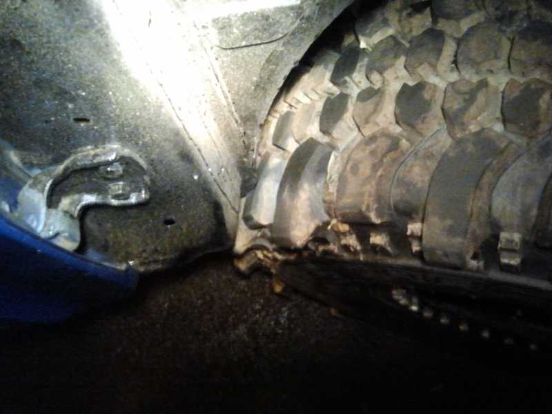

33s Rubbing was created by Smoggy

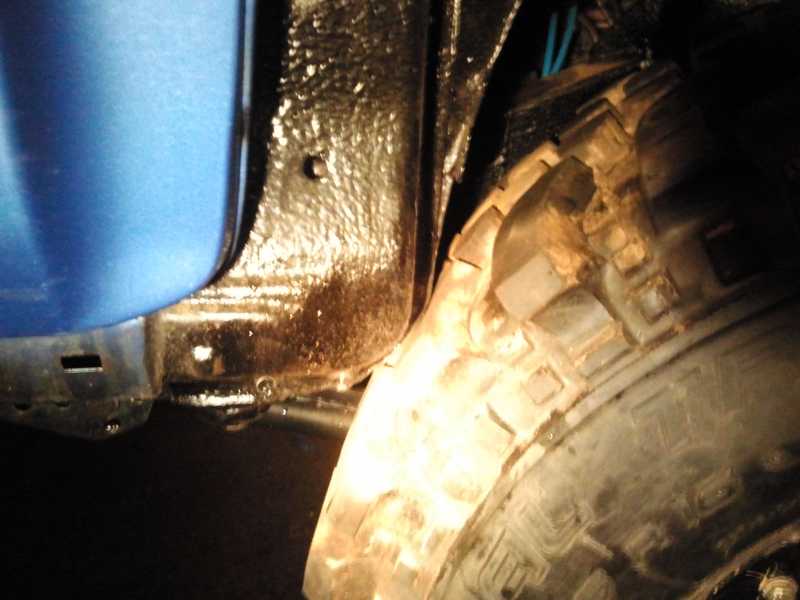

is that the hinge pillor for the door is it a box section
it can be cut and welded with thicker metal just to restrenthen it

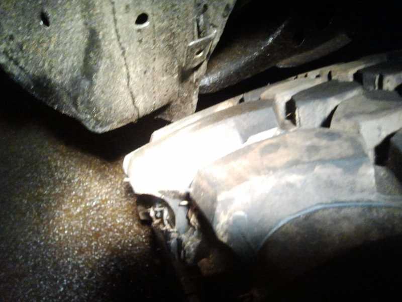

Looks tight in there mate , even with that material removed wont it foul under articulation on the rest ?
Have you not fitted the lift yet ?

Yeah it is the door hinge box section but because the main problem is at the bottom of the section I was hoping that cutting it and replating it further back might work.
Replied by Smoggy on topic 33s Rubbing
markyp2000 wrote: is that the hinge pillor for the door is it a box section

All the lifts are in place and thats just taken on the level with no articulation
I have some Grayston spacers which I could fit, this would also widen the track which might help stabilise things a bit - BUT I fear that with those tyres spacers would push the stress on the axles too much, even though they are chromo.
reaper wrote: Looks tight in there mate , even with that material removed wont it foul under articulation on the rest ?

Gazwell who sold me the 33s offered me the 1.5'' extended radius arms he has to help with the problem but I fear this may cause more problems by upsetting the castor angle by rotating the setup backwards?
