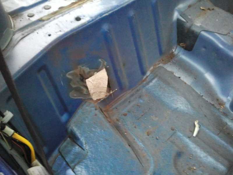

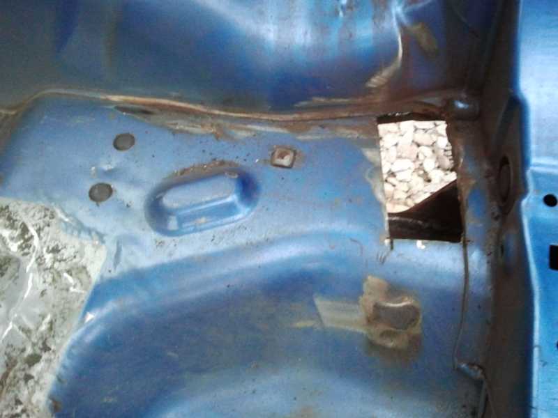

Mine looked okay too, til I removed the fuel tank. Just looked like small insignificant scabs from inside the car. Ended up with this:
This is the previously repaired repair above and below:

are you welding inside or out or cutting plates to fit holes
  • Smoggy
25 Jul 2012 21:37 - 25 Jul 2012 21:38 #44916 by Smoggy
Replied by Smoggy on topic Re: Ready to Underseal
Think i will weld inside cos its easier from above also cutting sheets to cover holes. The three squares together will cover with one sheet. Im not brilliant welding upside down tbh :)
Then i may paint rust converter underneath then smear joint underneath with sikaflex followed by some underseal/epoxy mastic.
Shouldnt come back then :)
Last edit: 25 Jul 2012 21:38 by Smoggy.

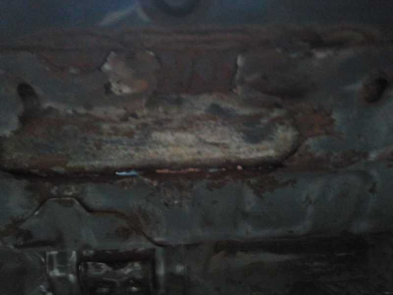

Anyone noticed that the rust in-front of the seat belt mounts is caused by a lump welded to the underside of the floor?
