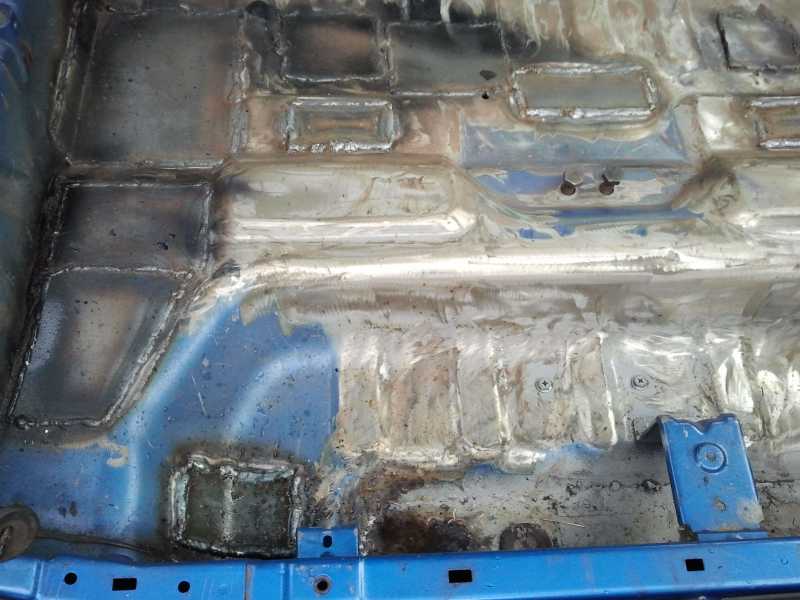

  • Smoggy
04 Aug 2012 16:31 #45462 by Smoggy
Replied by Smoggy on topic Re: Ready to Underseal
Finished the welding. 16 patches in all :blink: :sick:
Think il make a patchwork quilt if any more holes, anyway a bit of steel plate is a lot cheaper than a main dealer only complete rear floor section at £220 :ohmy:
