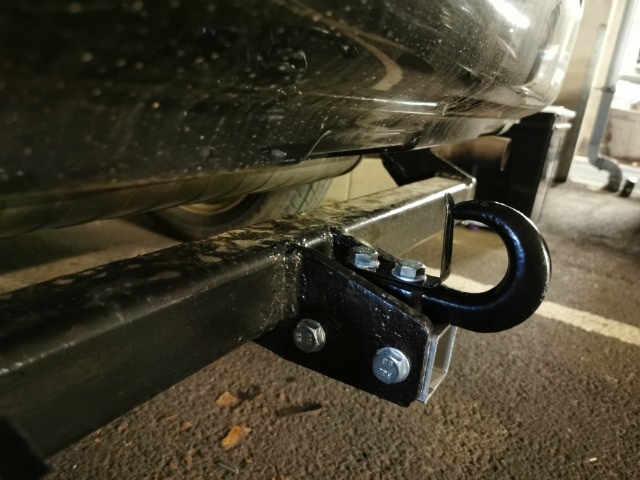

The problem as I understand it is partly because the load on the towball is not acting directly in line with the mounting bolts of both the ball and the chassis ends of the towbar and so the force is applied in both tension and moment of rotation. The adapter I'm working on will have less moment force applied as the whole assembly will be applied effectively in the same plane as the cross bar of the towbar.

Lambert - I had a similar idea for the towbar on my Grand Vitara, but ended up using a tow hook instead. To be clear I don't off-road my GV (that's what my Jimny is for) and don't think I'll ever use it, I just did this because I wanted a little project. I didn't use a steel bar and shackle as I couldn't work out how to do it without requiring an enormous shackle.
