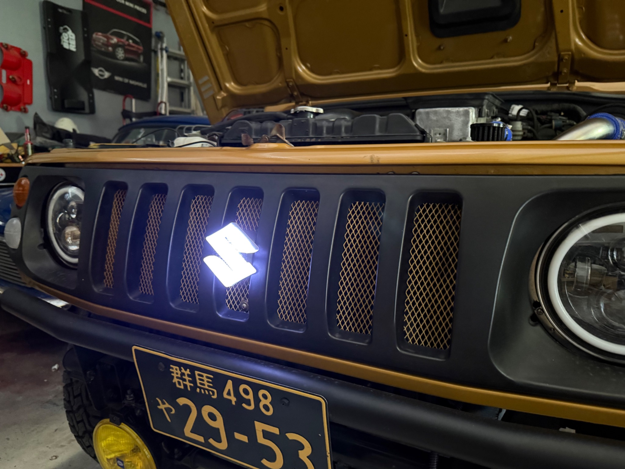

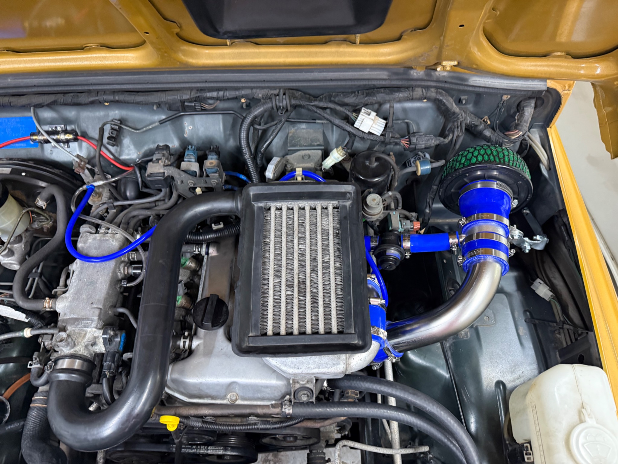

Installed an intake with blow off valve on my JA22! Ordered from Buyee and arrived to me in Tennessee in less than 2 weeks.
Been test driving and I'm not sure I love the blow off valve as I'm just not a fan of the noise, but it does seem to help spool up the turbo a little quicker.
I've also started playing around with a backlit logo for my grill. Still needs some tweaking, but it's a pretty good start.

All that blue hosing has to be worth at least an additional 50 horse never mind the bov! Lovely jubly.

I was hoping for more than 50, but I'll take it!!
