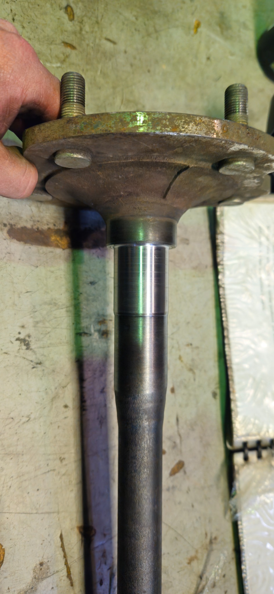

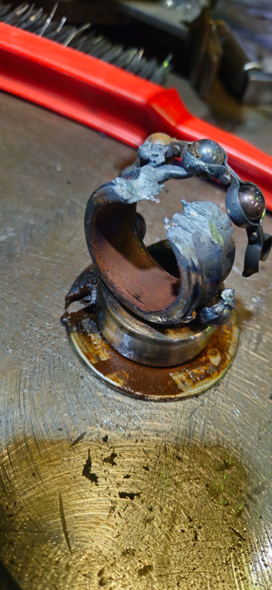

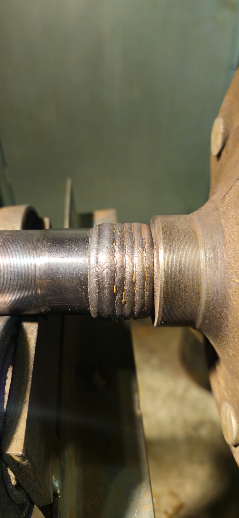

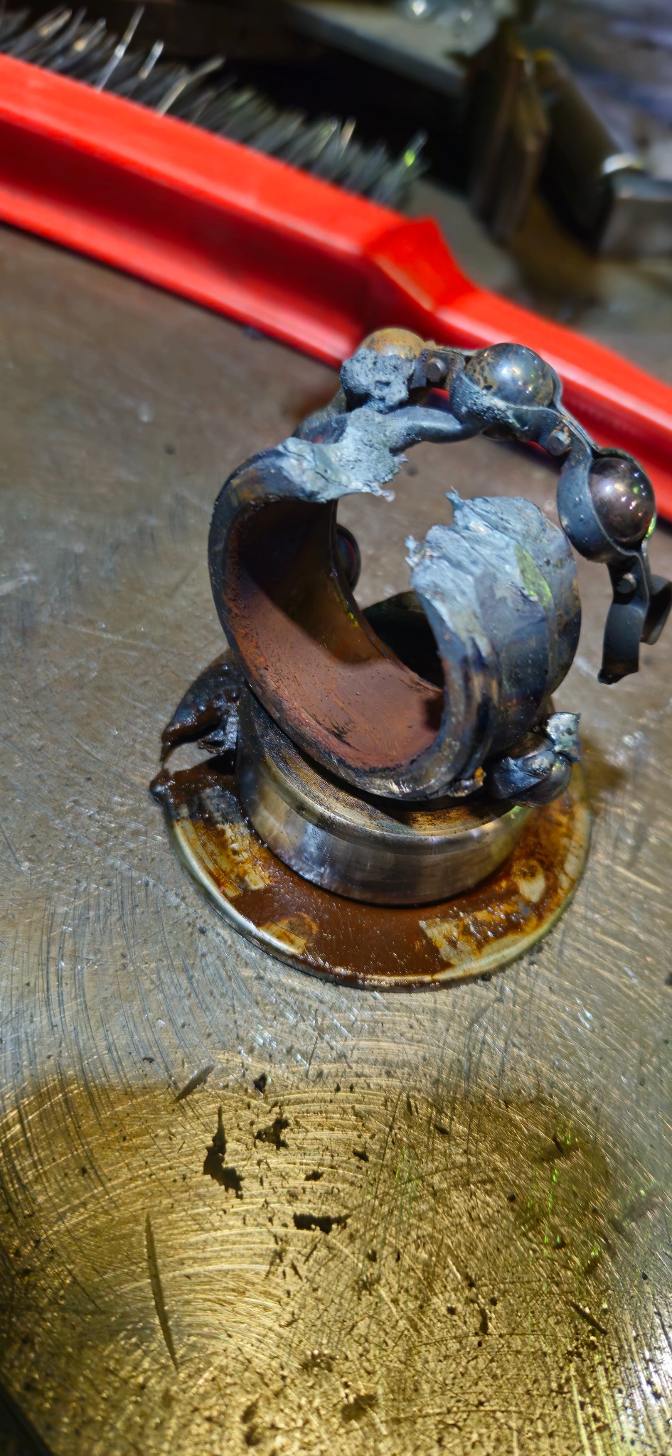

Had that feeling once again a rear wheel bearing was toast... Sure enough.
Must be the 5th bearing in 8 years.
Once again (it did this last time on the other side) the bearing seized and was now performing its job as a hardened steel bush.
Cut the old bearing off, skimmed the bearing diameter, built up and remachined the bearing diameter. Didn't remember to take photos of the worn axle.
