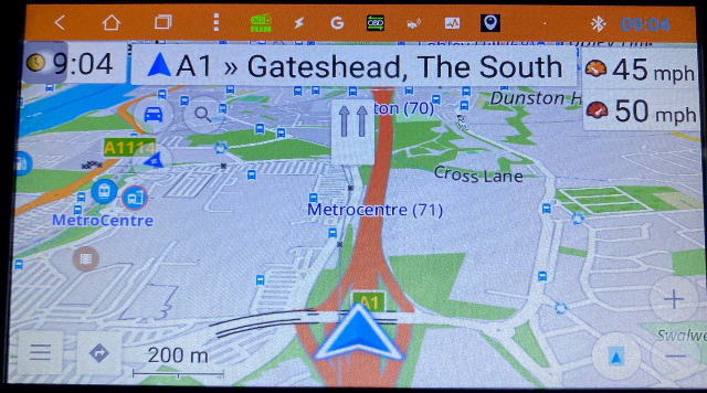

Installed the latest version of OSMAnd (Sat Nav, Open Street Maps) in to my Android head unit.
I have used OSMAnd for a while now as it allows your own GPX routes to be added and you can download all of the Byways, etc for your region from www.rowmaps.co.uk ), but it wasn't until the latest release that the Android version allowed the 2.5D (driving) view.
The screen is clear, bright, easy to see and the guidance (voice) pretty much standard.
Once you have your favourite off road routes added, it will even give you route guidance to the start and very likely as you drive along, at least it will show you if you are still on route.
Best of all it is free for 7 maps (each detailed UK region is 1 map) and there is a paid for version above this, but it's not expensive. Also runs on iPhone if you just want to use it on your mobile.

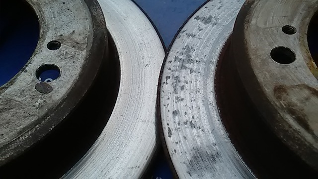

Finally today started to fit my new EBC disks and pads. The one being removed have just over 30k of very light use, but for sometime they have felt warped. You can see the problem in the surface of one, result of something else or just poor quality control?
These are Elcher from a car part supplier, very cheap at £25 each, so I guess you get what you pay for.
