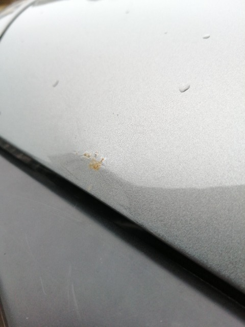

Had a SHOUT AND RANT at it for being a petulant Jimny and rusting just for the hell of it.
Having spent my time keeping the underside rust free it's treated me to a new area to add to the rust list. It's been visible as a pimple for some time, but over Christmas it's finally emerged. The new area is
drum roll
the bonnet
Rusted from within the double skin area, no reason or past damage to account for it.
Ok so next year I will be cutting it out, filling, waxoyling the bonnet and then I am going to get the bonnet and wing mirrors wrapped, black for a less cute look.
Can't decide if Matt black or fake carbon is the way to go.

My Jimny had a few stone chips on the front of the bonnet, but when I was doing those I also had to do a couple of rust spots on the roof, a few inches back from the windscreen.
There was no obvious damage area, it was fine when I bought the car and just developed. I rubbed it back, treated it and re-sprayed last summer.
Robin
Robin
