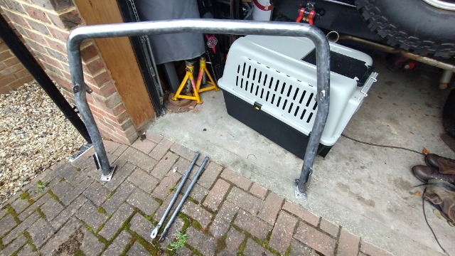

Today I spent hours removing the coating from James' roll bar
www.bigjimny.com/index.php/bigjimny-blog...eparing-the-roll-bar
