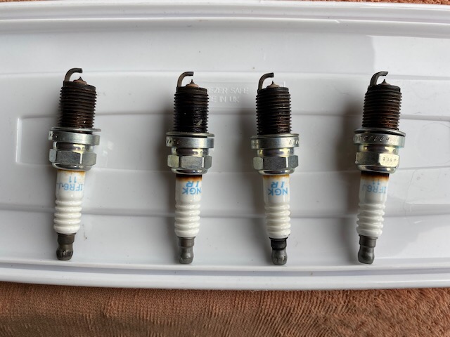

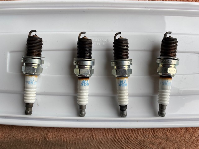

I cleaned and gaped my spark plugs today.
Here is the before picture, front plug on the left.
Think I need a new set.
I gave them a good clean with a wire brush, some wet and dry and set the gap. Then it was time for a road test,I like to think there was more power, certainly it seemed to rev better. I will how it goes for a week or so and pick up some new plugs.

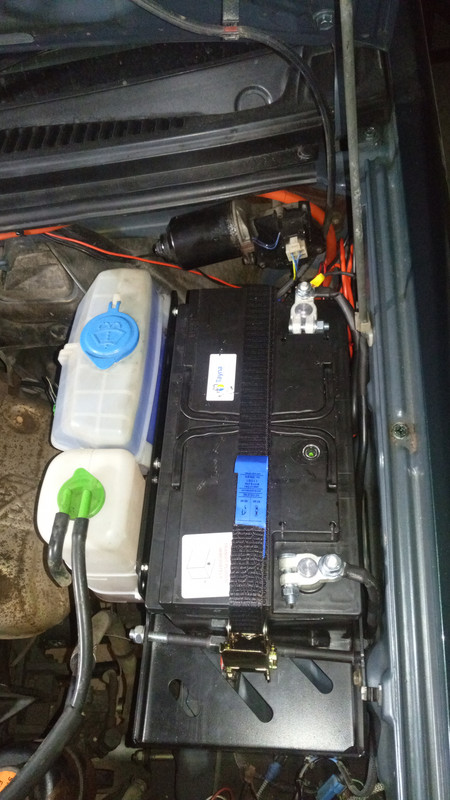

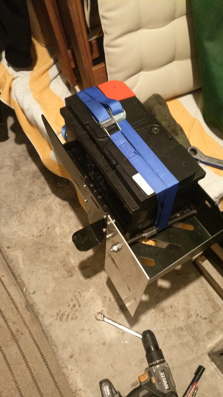

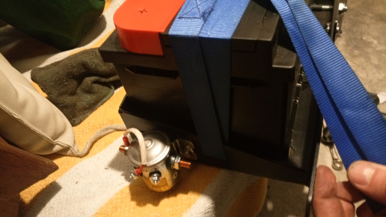

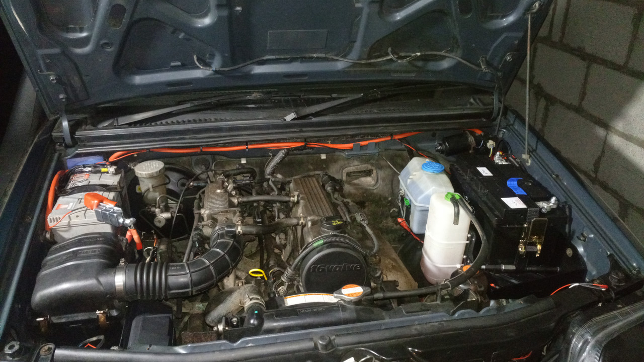

Spend a few hours last night modifying and fitting the additional battery tray.
Quick test-fit:
Solenoid mounted on the rear tucked out the way:
Plate for fuse box to be mounted to (eventually):
All the necessary wires poked through the firewall for the dual battery system + aux power in the car:
All installed and hooked up:
Quick overview of cabling:

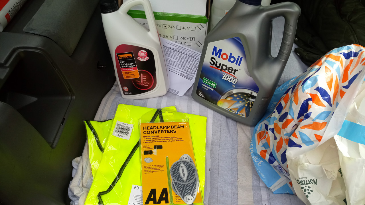

A few bits and bobs bought and a few odd jobs completed to prepare the car for a few days of driving down to Rome next week so my Italian girlfriend can see her parents once again.
Grabbed some spare coolant and oil which I can decant into some more suitable sized bottles for taking with me as well as all the other bits you need for driving through Europe.
