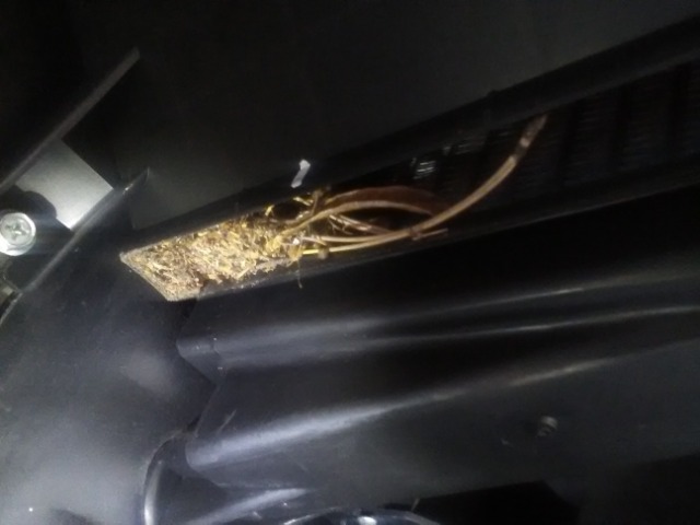

With all thel lockdown related grass cutting that's been taking place the pollen count for the last two months has been High to unbearable. The better half is suffering accordingly, so to ease her pain I have ordered a pollen filter from Martin to fit in our Jimny. I decided to take a look to check I could remove the cover (just in case I broke it) and see if it had one fitted.
As expected it did not, however the matrix and filter box contained a surprising amount of pollen related debris and potential bird nests !!
Just think whats been blowing in our faces.
This is what remained after the majority fell into the foot well after removing the cover !

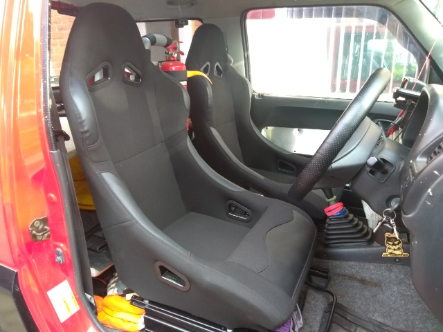

Do they have a pad for your bum to sit on? Can't figure out what the raised bit is for on the front edge of the seat.

That front leg bolster is to stop you sliding forward under the seatbelt in a sudden stop. It's known as submarining. It's less of an issue with a 5 point harness with a strap between your legs.

They come with a pad,but the step in the front is way to much for my needs
So just in the process of making a new base,this will fill the gap level and make them more comfortable for my needs
