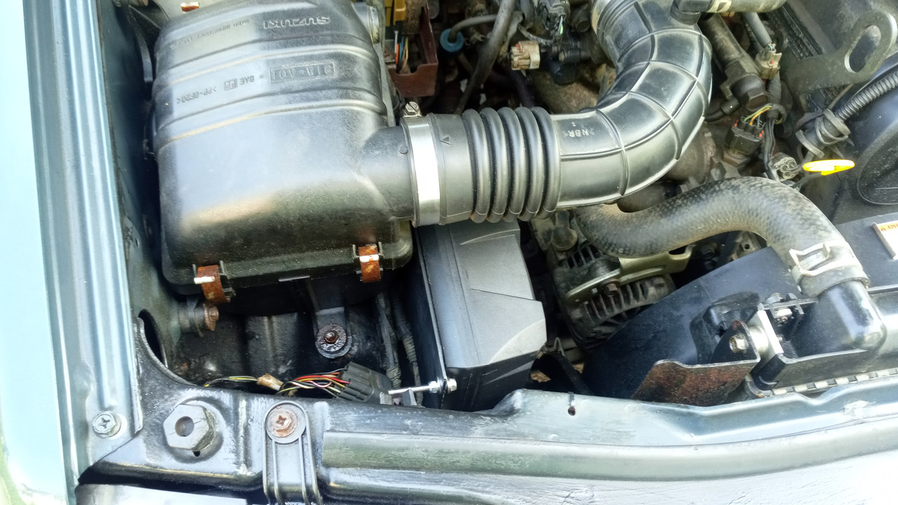

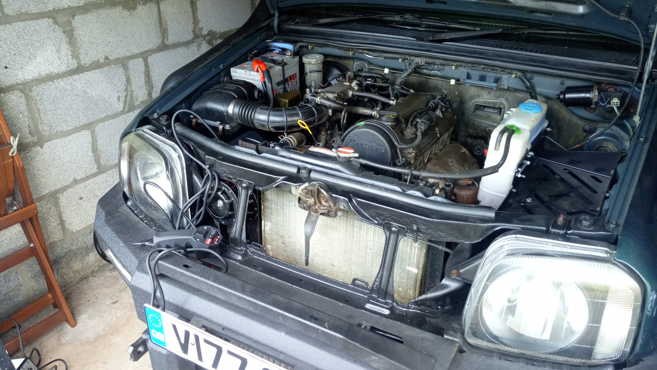

The winch is finally wired in and working!
I found a nice spot to put the control box just next to the (now understood to be) 'fuel evap canister'.
First step was to make a bracket with some sheet steel. A bit of cutting, bending and some holes drilled and voila.

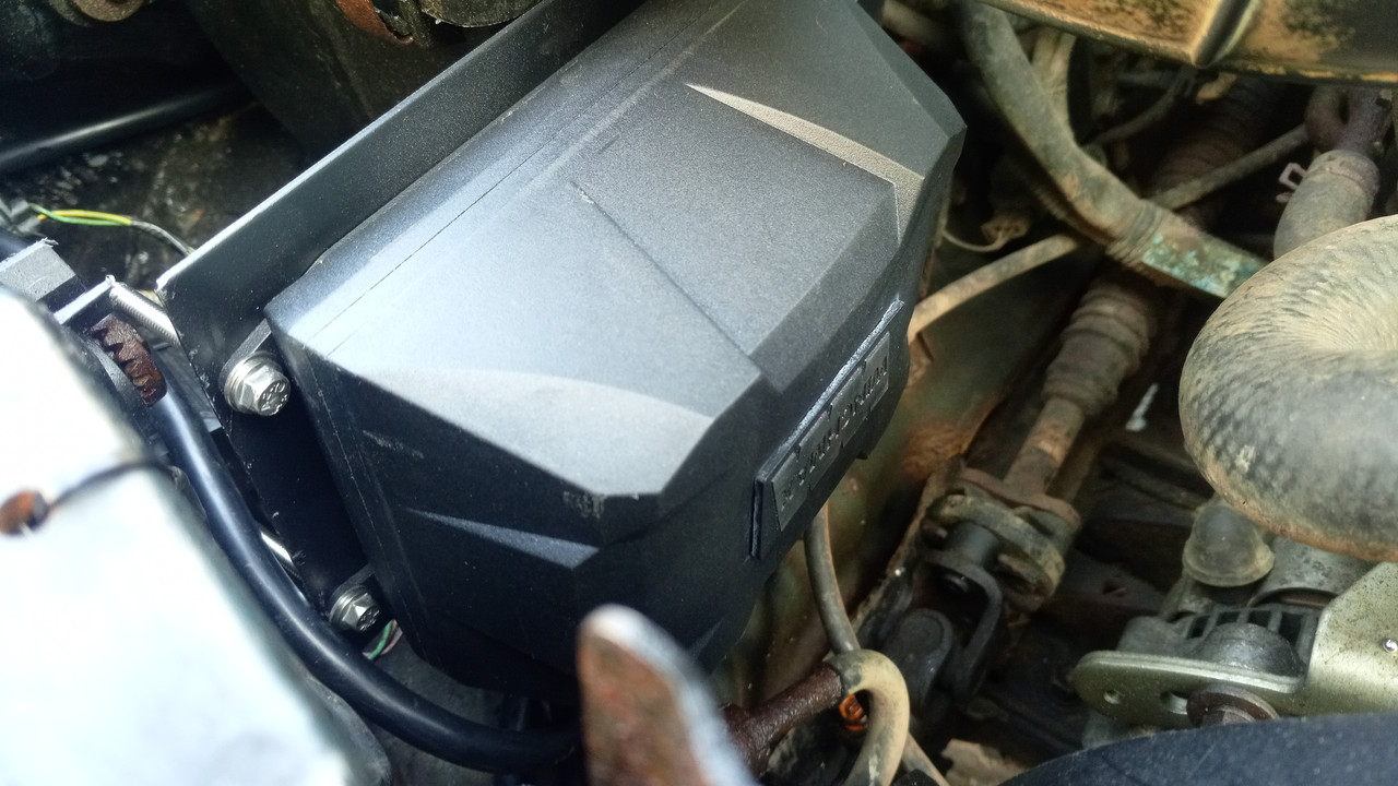

A quick test with the controller attached - easy enough to get to the control box wire input but I will be relying on the wireless controllers mostly.

Is your winch a winchmax one? (the controller looks like mine). I discovered that the solenoid box isnt that waterproof and the little black box inside it for the wireless reciever is not waterproof at all. Mine failed predictably so I had to buy whole new controller and receiver setup complete. Luckily it still worked on the wire, but was annoying for a while.

I had a bit of a poke about before installing it with a view to figure out what might go wrong if it ever did - it seemed OK. From memory, I wanted to check the receiver box didn't have any holes in it. It had multicoloured wires going into it which were heavily braided and kind of hard siliconed in one side of the receiver - does that sound the same to how yours looked?
I will take it out though and have a look to check it over more thoroughly and pay more attention to the other bits in there if you say you have had issues with water. Did you do anything extra to help waterproof it from that point on Riccy?

yes it was the little black box inside the solenoid box. Its sort of glued together with what looks like hot melt glue. Lasts a while, then goes brittle and leaks.
When I phoned winchmax up to ask about spares they even told me that that part is not waterproof. Surprising really when its meant to be stuck on the front of a car in all weathers. I bought the new ones from amazon for about £20 i think. Not as nice to look at, but do the job.
On the replacement receiver I drilled some small holes and filled it with electricians silicone (CT100 I think its called, but any silicone would do). Not tried dunking it yet, but ok so far. I also wired a switch onto the dash for in/out as a backup to the wired winch controller and two wireless ones.
