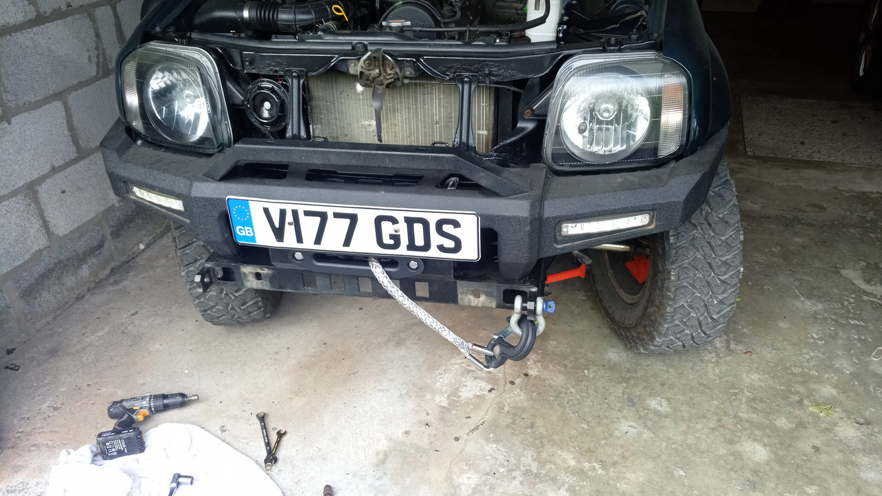

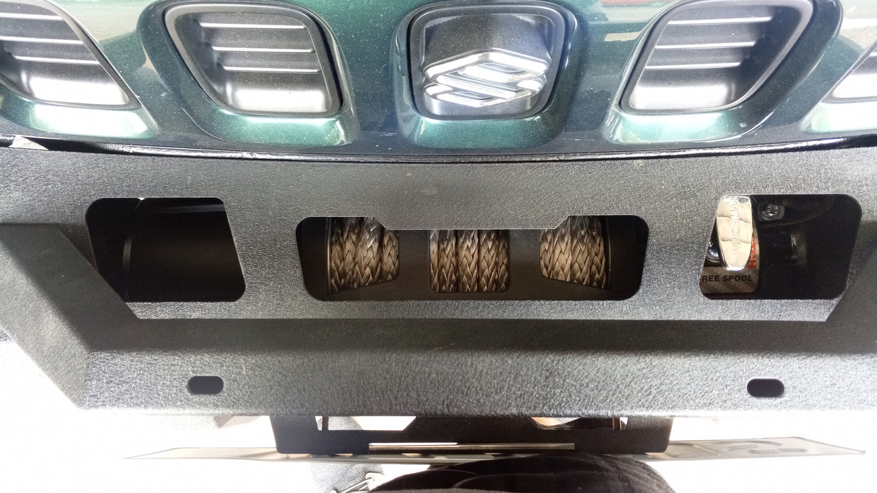

Over the past two days I wanted to install the winch.

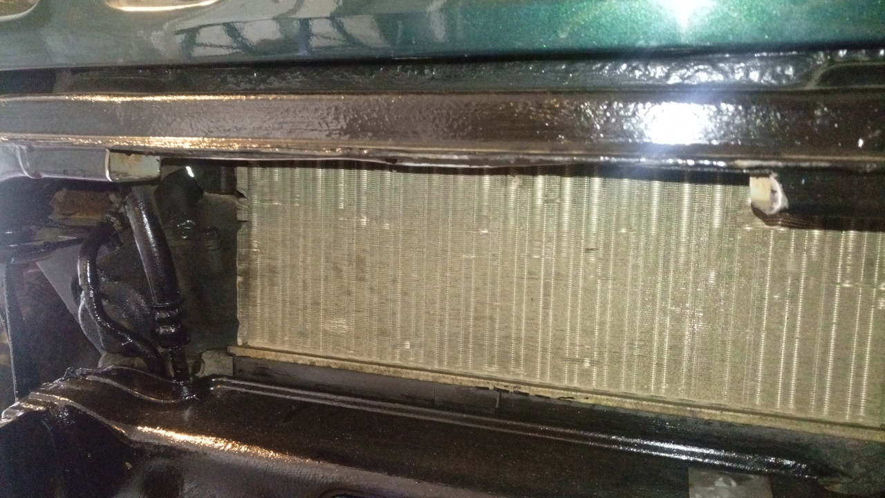

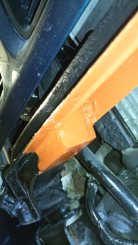

I firstly had to notch out a piece of the front slam panel as the winch was catching slightly.
Welded up the cross-section with some plate on either side to seal the cross member. Painted in red oxide primer and then black.
Installed the winch on the bottom-half of the bumper assembly (winch plate) after feeding the winch rope through the fairlead.
A snug fit but I can still get to the clutch/free spool handle.
All installed and finished. Admittedly quite anticlimatic because I can't really see it! But at least I know it's finally installed and ready to wire up.

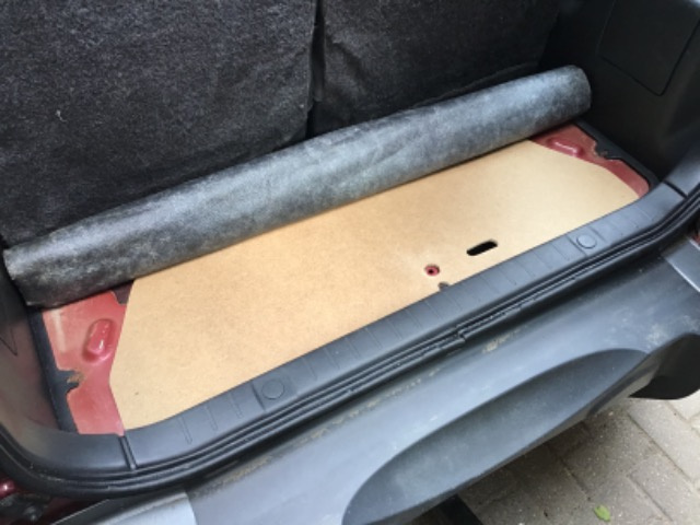

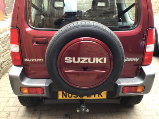

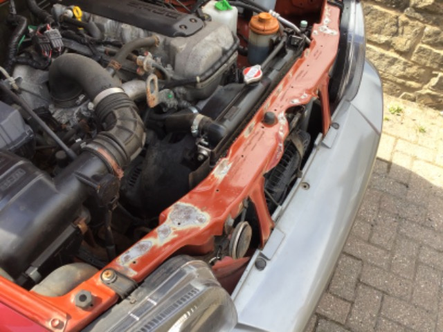

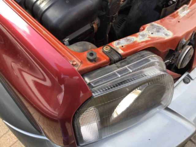

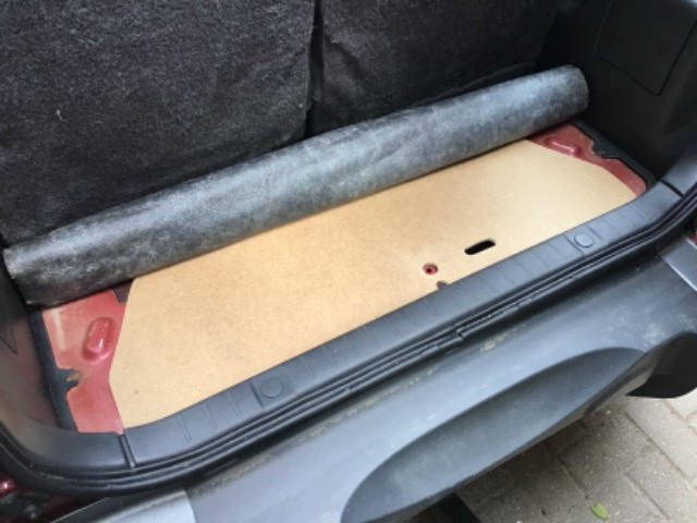

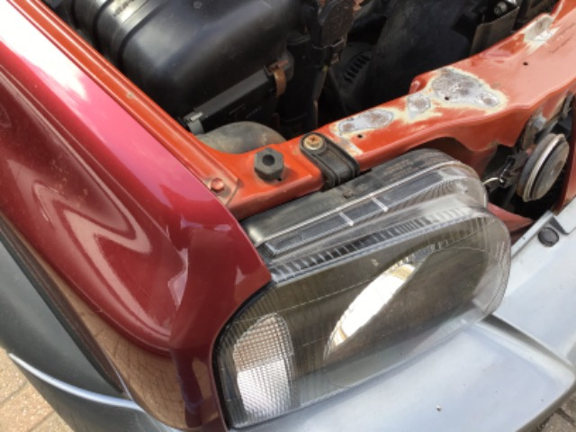

Today I
Re mounted the back wheel following complete refurb of the mounting hub, inside of the alloy, tow bar.
Fashioned a replacement boot tray
Rubbed down and rust treated the spots on the bar across the front of the engine bay
Does anyone know what the colour of the paint is in the engine compartment please it’s not the same as the red on the car

Mine is the same colour car as yours and i used Hammerite red oxide primer.

Ah great I bought some Simoniz red oxide spray cans so will have a go this weekend.
