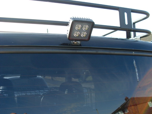

Fitted worklight onto rear door. (easier than fitting to the roof/rack IMO
Just unplugged the screen demister wires, extended them to worklight and
now it runs from the rear window heater switch. For now anyway, until I can

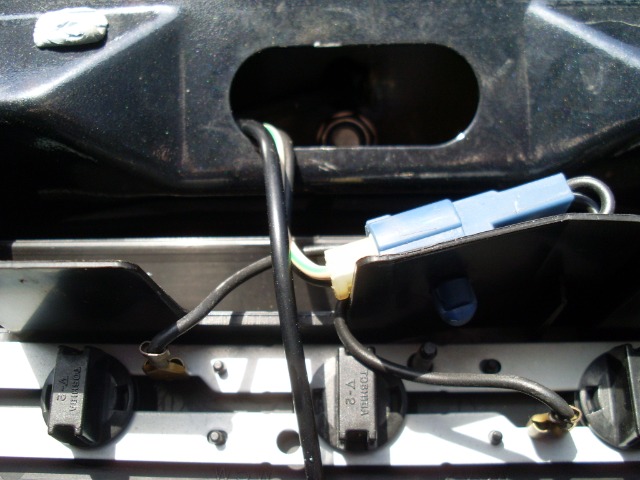

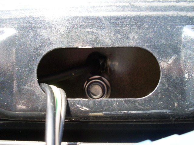

get a Live feed into the back door! I'm wondering if I could get another cable
through the r/door harness flexy conduit?

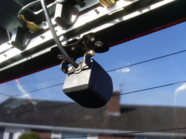

Any way, while I was there, I fitted a WiFi reversing camera on the inside of the window...
It only needs a 12v feed and Thanks to a post by Scimike, I wired it up to the switched

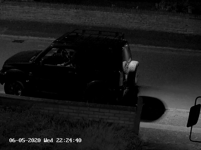

Live to the wiper motor. The pic quality is better than I expected as its looking through dark film and,
I can monitor the view on my tablet in the House!

Excellent implementation. I like how you have done that - nice and neat.

Easily fit extra wires through the sleeved grommet
I managed to get 6 extra 1.5mm tri-rated through mine

SIX ! Are you familiar with surgical procedure Jack?
07 May 2020 17:27 - 07 May 2020 17:31 #221996
just pop grommet out of body leave in the door use a firm draw wire
Replied by jackonlyjack on topic What did you do to your jimny today?
No mate just needed wires for fog,reverse,number plate it's not to hard a procedureTillymintDLG wrote: SIX ! Are you familiar with surgical procedure Jack?
