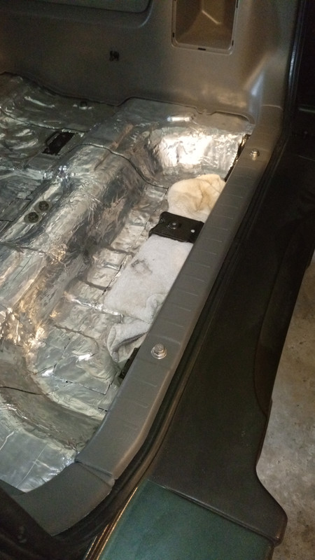

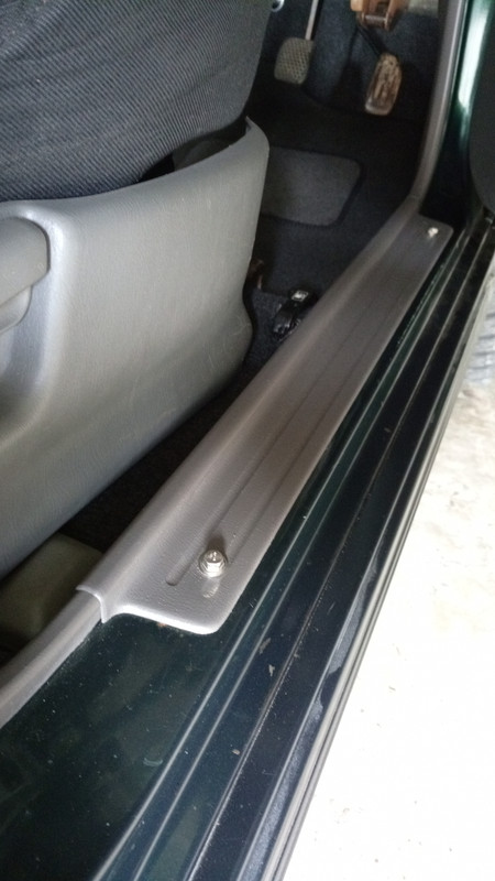

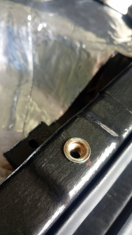

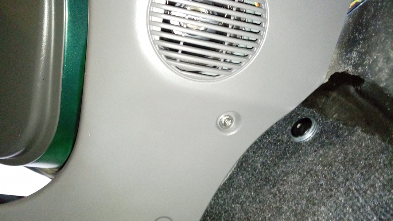

Spent a few hours using rivnuts and painting interior panels. I can now bolt in my panels rather than using the crappy plastic clips which keep snapping.
Rivnut in rear door sill:
Rear door sill cover (primed, painted) bolted in:
Passenger side footwell speaker plastic trim sprayed and now attached with bolt. Also sound deadening material inside speaker housing.
Interiors coming together. Just the door sills and drivers footwell plastic to fit then its back to normal in the front.
