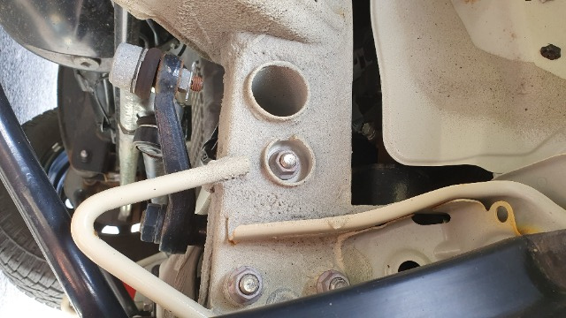

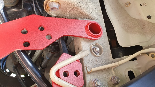

Well today I fitted one of the Radius arm guards I have. It fitted very well (new old stock ORA), so a pat on the back for that.
It's been at bit of an on / off love affair with these.
I don't need them as I will never push my Jimny into the sort of terrain that needs them, so I was fitting them purely to get them off my shelf.
After fitting it became apparent that they present a potential mud trap between the radius mount and guard. The beveled edge on the Jimny mount reduces the clearance between the two, and it also hides any potential corrosion. The thickness of the mount also potentially reduces the clamping force on the radius arm bush, simply part of the 90Nm is now going into compression of the mount. Probably not an issue, but I don't like the idea of a suspension mounting point not operating at the correct preload, just in case the bush rotates rather than being clamped.
So today I removed the one Radius arm guard I had fitted !
Great if you need them, but not for me unfortunately.
Back on the shelf :laugh:

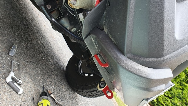

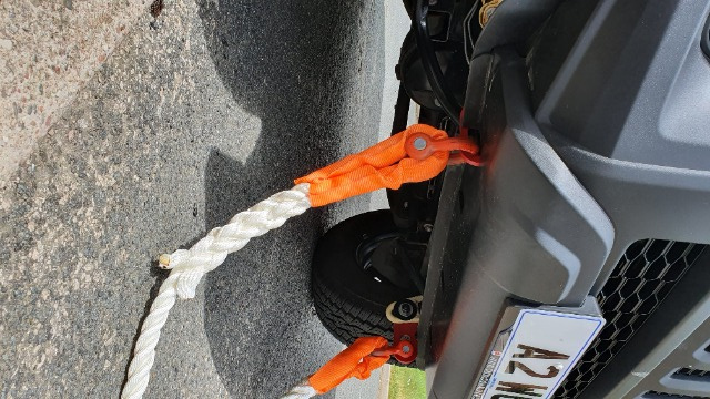

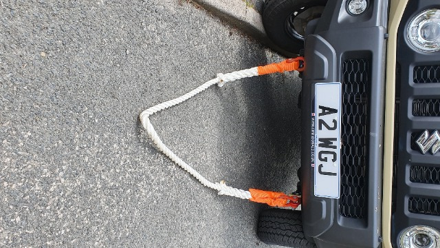

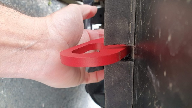

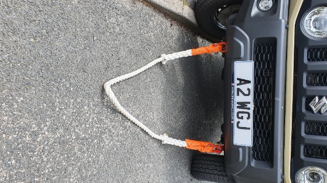

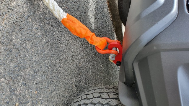

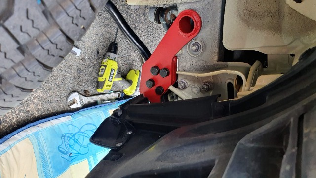

Fitted my Front Right Recovery point today. Had to cut a wee slot in the bumper but quite easy to do. No way you would know unless you were specifically looking for it. A lot stronger and bigger bolts than the front left. Only problem being that I believe it should have been extended by at least another 20mm. It's very difficult to fit the shackle. In fact you have to fit the shackle back to front. Interested in peoples views on this? I have read and seen elsewhere when a slot rather than a hole it is fine to fit the shackle back to front. Any way using both front recovery points with strap is going to be a lot more secure than the original tie down points. Only need to find somewhere to get stuck now.

Replied by jamie_300 on topic Fitted Front Right Recovery Point Today
where did you get the strop to connect the two points from i've been looking at those for ages but the ones i seem to find are always too long.
