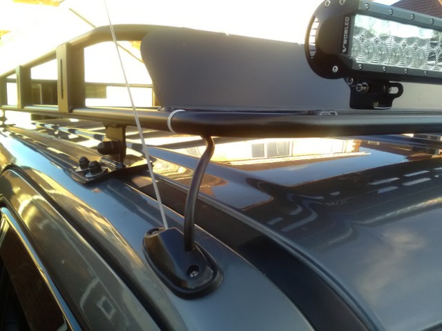

Finished wiring my light bar via the Ariel route.
I had to use a thinner cable first fed from the top as a "path finder", then I pulled the final cable in from the bottom. It enters the car just above the front driver side speaker. Hole in mount sealed with Cyno glue as the drilled hole was a nice tight fit to the cable.
The only negative is this route puts the power cable in close proximity to the Ariel (obvious), so I can hear the diode switching buzz slightly on the FM radio. Not an issue for me as I stream / MP3 my music, but one to note if anyone else wants to take this route.
I have at work some thin Stainless steel flexible conduit, so planning to make a cosmetic cover to protect the cable further and maybe experiment with it as a RF shield to reduce or eliminate the noise on FM.
Final cable entry point
