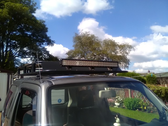

Fitted a light bar, not because I need one, more to make it look a little different to all the Cashcows, Pukes and the rest of the SUVs out in the world. I now have the famous "how to get the cable in" dilemma without resorting to a snorkel. When I've figured it out I'll post some photos.
The sun even came out to have a look!

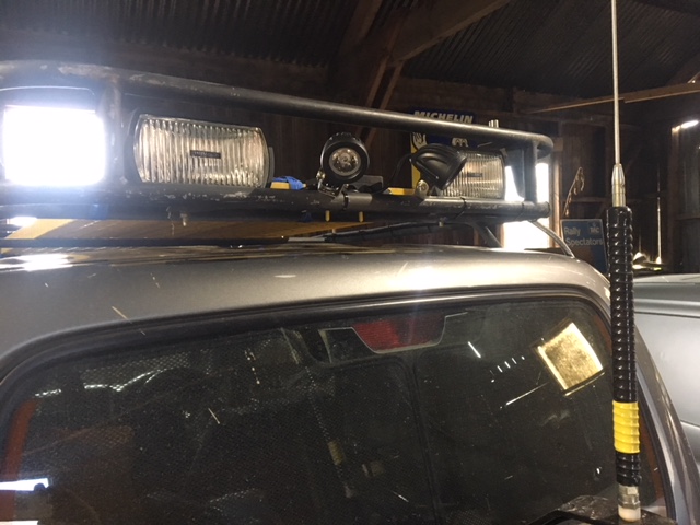

I ran a multi-core SY flex up there, looped it down and in through the door rubber alone. Zero holes drilled. It goes to a junction box on the roof-rack, then connects to various lights that way. The SY flex is because it has a sort of metal armouring layer, and looks pretty :laugh:
you can just see the cable peeking out of the hinge side of the rear door here...

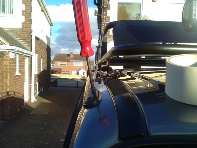

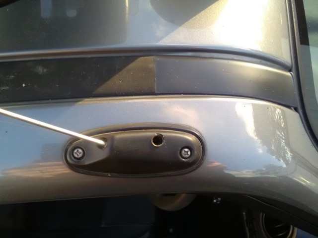

Thanks for your suggestion Riccy, running the cable to the rear was on the cards if getting it in via the A pillar turned out to be impossible.
However today I investigated the possibility and went for it with my drill. Yes you can get a cable in via the aerial mount without damaging anything.
The following pictures show the hole position, I am just waiting for my cable to turn up, already pulled through a mains flex cable as a tester.
Going to use an XT30 connector to allow disconnection and profile Ariel mount plastic for a better exit angle, sealing with black silcaflex.
Hole position from top
Screw driver inserted just to show angle of hole as drilled. This clears both the Ariel important bits and the bodywork.
Will post more pictures as I wire it up.

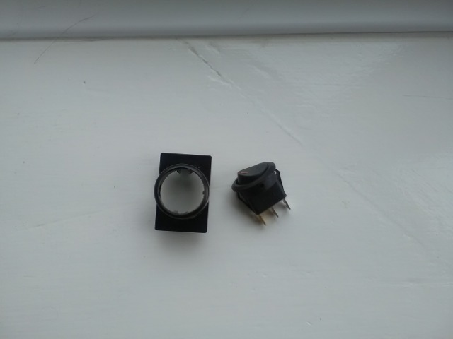

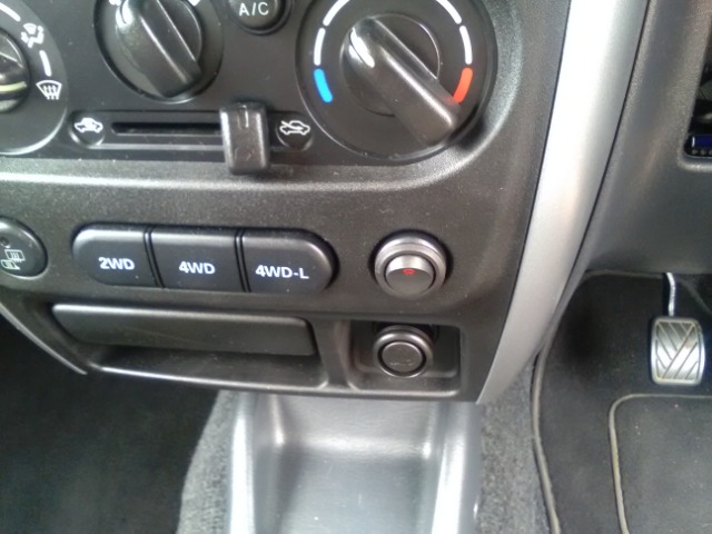

Today I made the light bar switch mount using the " I don't know what it's for blanking button", mounted switch and fused relay. Just waiting for my 12v red / Black cable to arrive and I have working light bar. It's cheap and Chinese, I'll report back with any issues, but so far so good.
Switch and drilled Jimny blanking button.
All fitted ready, pleased with the look even if I do say so myself :laugh:
