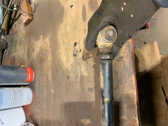

Been hunting the cause of a worrying shake and rattle sound from the driveline today. I was almost convinced the transfer box bearings were gone so started pulling the props off. Feeling the box as i turned the various inputs/outputs and listening it all sounded ok. Did the same with the gearbox. Checked the oils. No problem found
Looked further back and found the rear panhard rod adjuster nut was stuck up from where it should be and the rod rattled on the thread. [strike]Took it off[/strike] cut it off (bolt cold-welded itself to the bush insert
). Lots of play in it so pinched the new one destined for Ulysses and fitted that. Need to weld this one to fix it i think, but needs length set first for Ulysses.

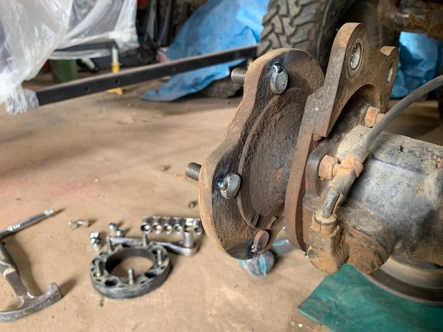

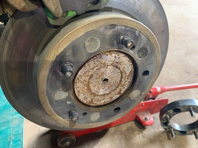

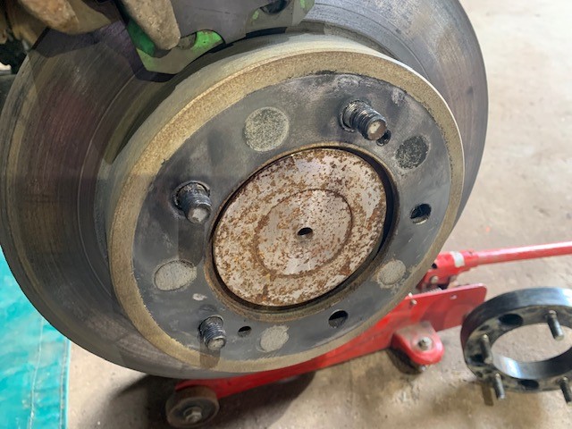

Another look around under and realised there were some wheel studs missing from the passenger side rear :woohoo: :blink:
Pinched some from an old shaft and welded the buggers in this time :laugh:
Test drive and Yay! its fixed the mystery worrying noises
This goes to prove that the cause of a noise, wobble or vibration can be far from the obvious thing sometimes. Just glad I dont have to rebuild the transfer box!
