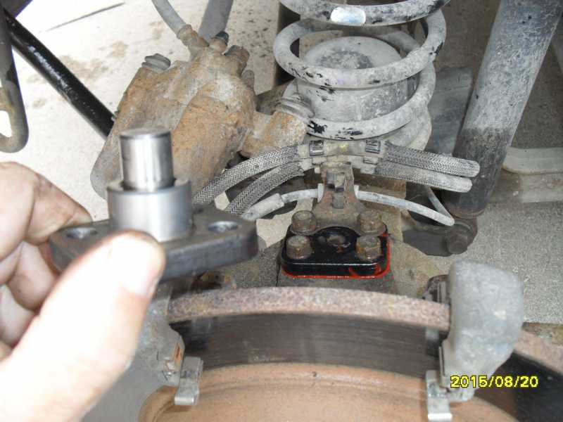

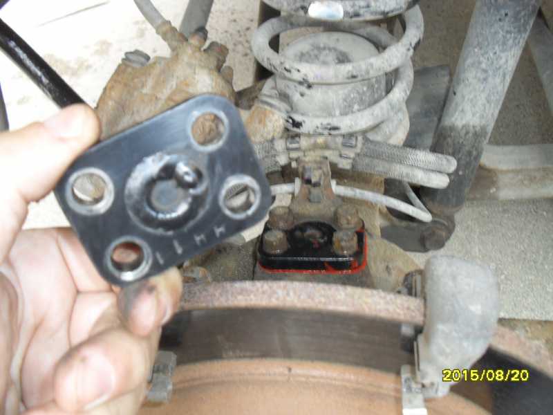

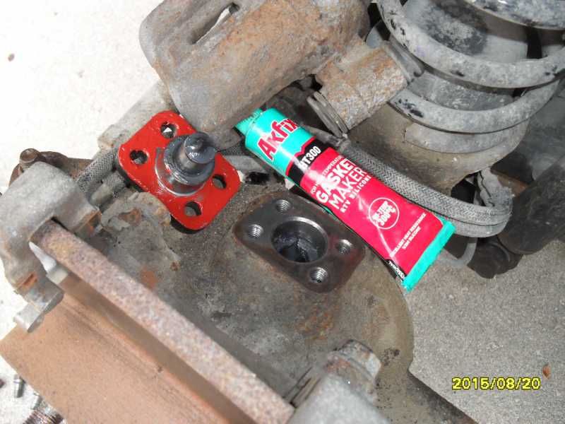

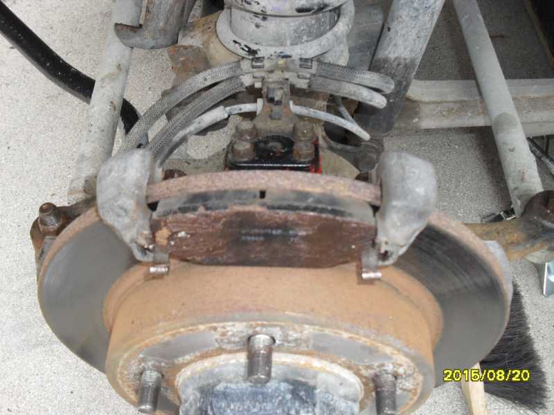

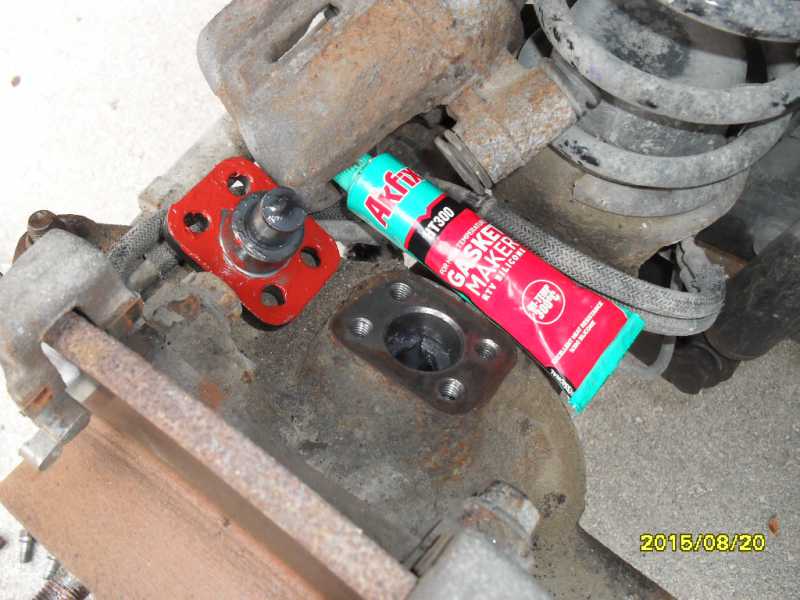

Packed some grease into the near-side king-pin bearings today, they looked to be dry, and there was no sealant
to stop water ingress. My off-side was replaced the other day and the top surfaces of the pins were well rusted and crusty, but the near-side were not they looked new so I guess they were replaced last year along with the bearings, maybe it had failed the mot before I bought it. My surprise was 1. very little evidence of grease on withdrawing the pins both top and bottom and 2. no sealant evident. I packed some grease in and sealed them with 300 degree temp silicon.
Gave the brake a clean and copper grease were I should to keep things moving.
Hope this helps with your rebuild....

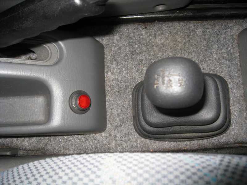

Fitted a 2wd low switch
Switches are expensive! In The Olden Days, they were a few coppers, now they are 20 times more expensive.

Thanks Facade, I was thinking about this a couple of week ago but couldn't find the link,
if anyone's done this on the switch select 4wd models, please let me know, else a little detective work will be required.
found Busta's OP here
