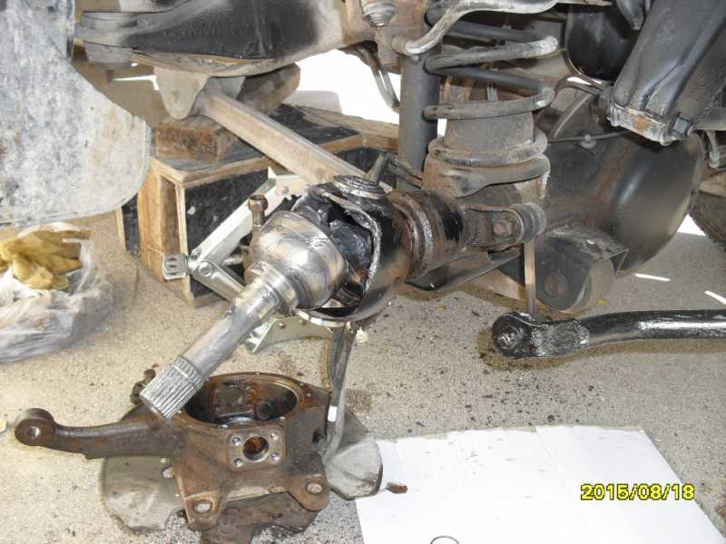

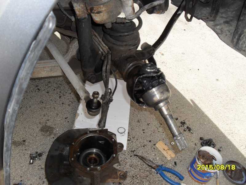

18 Oct 2015 16:50 #153869 by BGBrit
Replace the king pins bearings on the off-side wheel with the kit I received from big-jimny-shop followed the how to on this site and had no problems carrying out the work. Used my stick welder to blob the races one at 10 o'clock the other at 2 o'clock came out with a few sharp blows using a punch and club hammer.
Gave the brake a clean and lub while as was at it. Took me 7 hours needed lots of tea-breaks.

  • Daniel30
18 Oct 2015 21:10 #153887 by Daniel30
Replied by Daniel30 on topic What did you do to your jimny today
Nice work well done :)
19 Oct 2015 05:37 #153895 by BGBrit
Thanks Daniel,,,
There were three points I discovered, which might be helpful to others doing this on a 2009 model.
There's no need to remove the four bolts holding the disc backplate, as these are prone to be rusted a did round one off and had to cut the head off, but as I say it wasn't required, so wasted some effort there (unless I'm missing something) Also the seal for the drive shaft I tried all tools to get it out, It a tight space and slippery too, finally a pair of pump grips just nipped it and it pop out in a second (I used to call them footprints). One other thing on the end of the drive shaft there is a m8 threaded hole I used this to screw in a temporary bolt then pulling on it, brought the shaft to the right position to clip in the circlip.
BGBrit.
