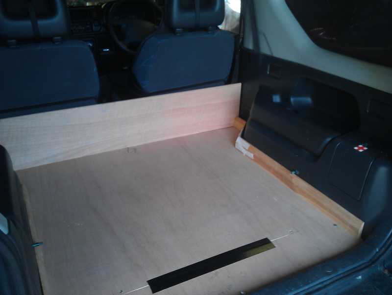

Final test fit of loadliner :
  • markyp2000
04 Dec 2013 20:08 #94567 by markyp2000
Very neat and posh lol looks well thought out
  • helijohn
04 Dec 2013 20:50 #94595 by helijohn
Boomer wrote: Final test fit of loadliner :
I like the lips, done a good job there pal. B) ;)

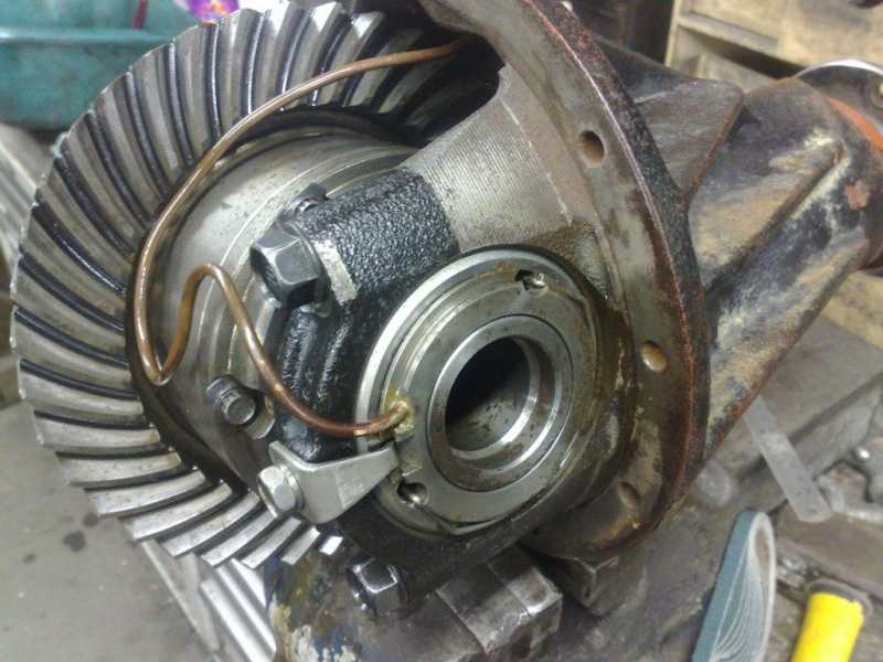

Rebuilt diiffs on Yota 70 axles new carrier bearings and pinion bearings re installed ARB air lockers threw crush spacers away and made EN24T solid spacers lets see them give up under load :laugh: and enjoyed an evening of king pin and wheel bearing fitting and setting up :sick:

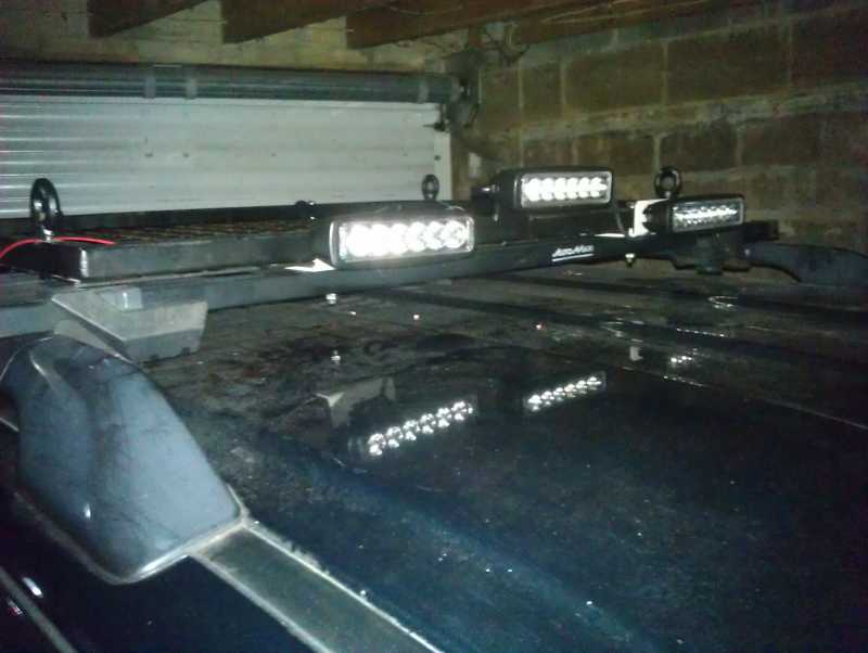

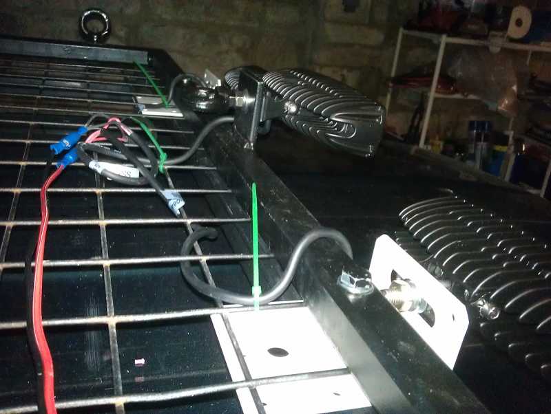

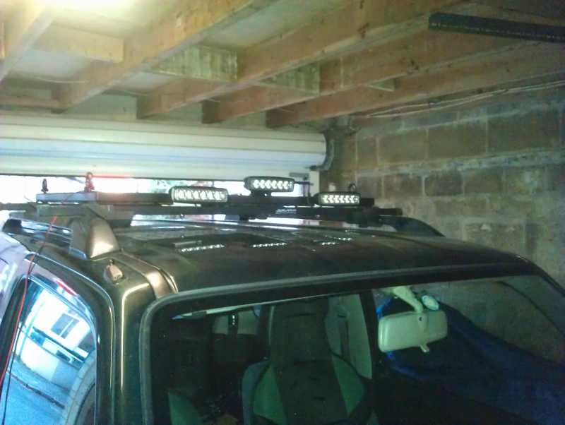

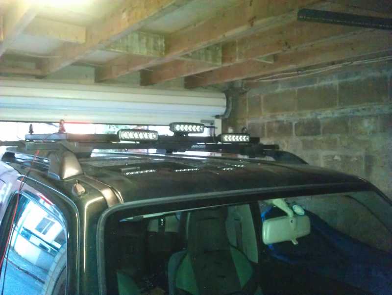

Final test fit of spotlights:

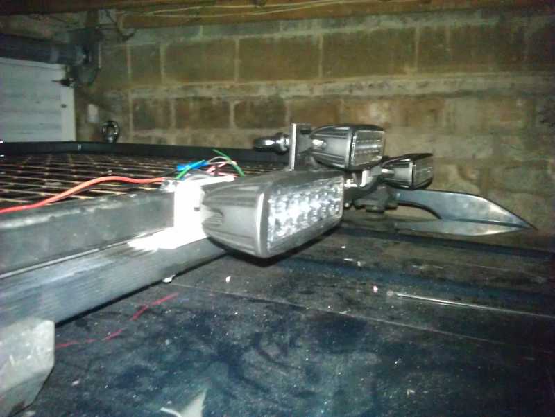

Quick bit of dodgy wiring:
May not look big and impressive:
But did turn this:
Into this:
Now just have to work out the perm wiring .. :unsure:
