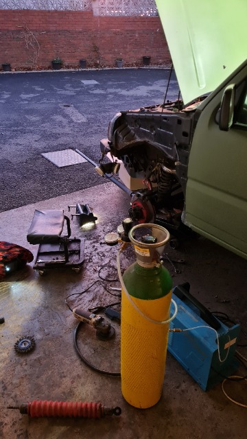

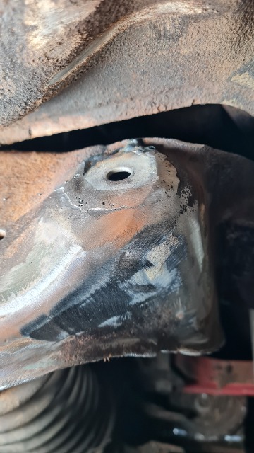

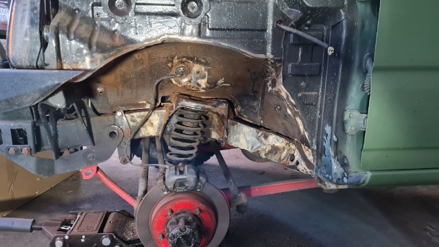

Sorting out the passenger front wing. I don't have arch liners anymore, so giving it a scrub back to inspect. Lucky I did as the shock mount was cracked (the driver side blew out last year on the way to Italy on our road trip). Welded a washer in for the time being to strengthen it up.

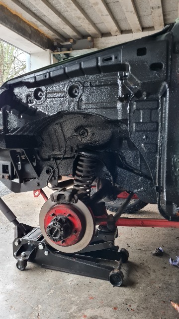

Tomorrow I will scrub it up a bit more and rust-encapsulate and then paint with buzzweld products.
