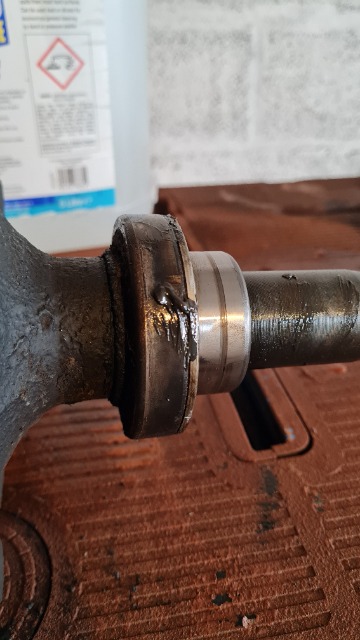

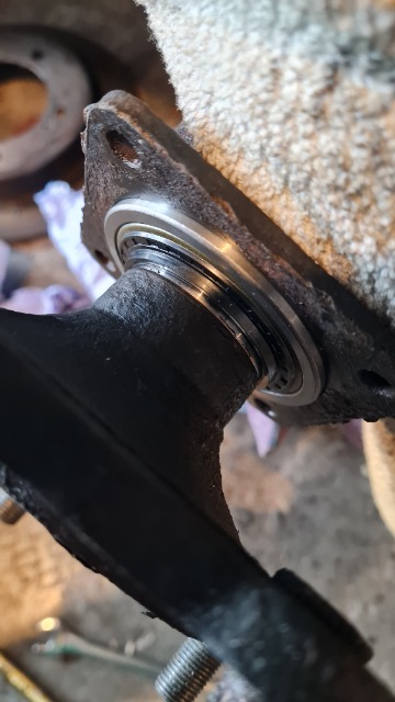

Saturday was a busy day. I set about fixing the rear bearings on the car. I hadn't ever done them and I was convinced at least one of them was broken given the whirring noise I have had for the past few months. I've got disks installed so it wasn't such a worry given the axles wouldn't fall out.

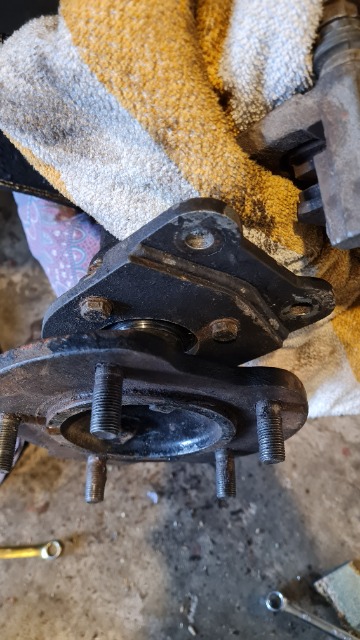

Getting started removing the 4 bolted backing plate for the calliper:

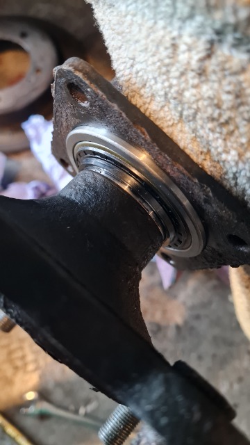

Inspecting the old bearing - both sides looked identical and were both equally shot:
All pushed in and then the backing plate went back on:

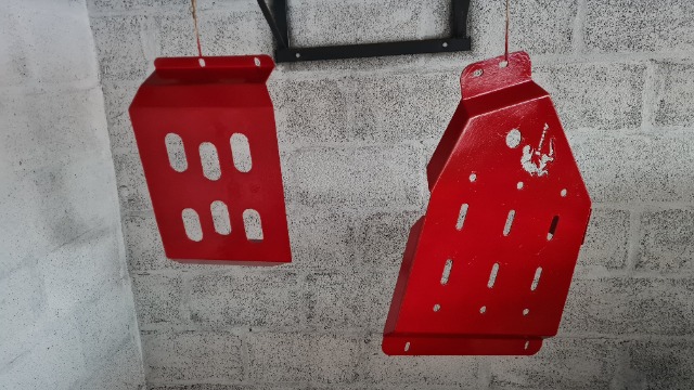

Cleaned up my rusty old transfer box and fuel tank guard in bright red (only paint I had left):

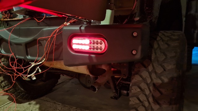

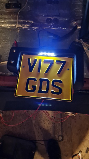

Finally got all of Keith's body panels fitted and wired up. New fog light and a new numberplate light made with 12v LED's:

I might be missing something here, but where is the equivalent of the backing plate that holds the half shaft into the axle case?
Roger
Roger
14 Nov 2021 20:14 - 14 Nov 2021 20:16 #240129
Replied by Riccy on topic What did you do to your jimny today?
It is the bracket visible in the first picture Roger
