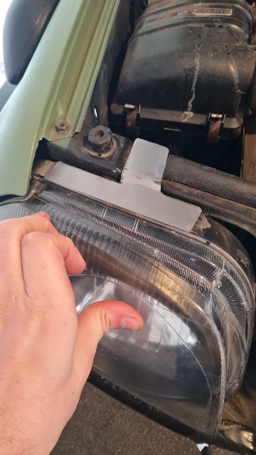

Had to make a little bracket as one of the plastic tabs had broken off the top of the headlight:

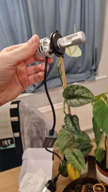

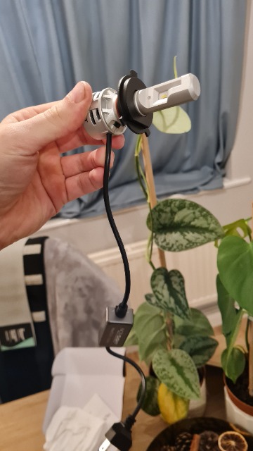

I also learnt the LED bulbs are illegal for the purposes of the MOT, so just need to remember to put the candles back in when it's time for testing.

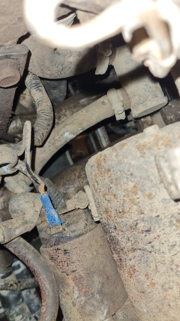

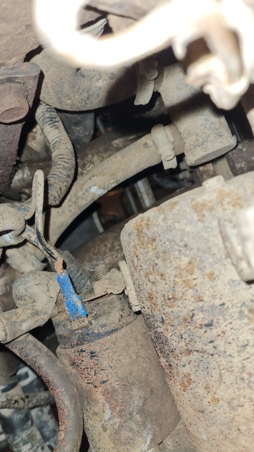

Did a bit of undersealing with a paintbrush, only to get fiddling and broke the connection to the starter motor (it was severely corroded!). It looked connected but the wire had come apart inside the blue rubber housing.
