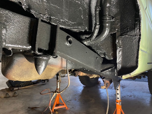

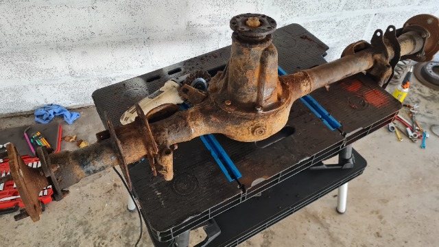

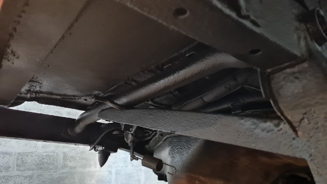

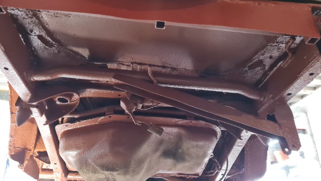

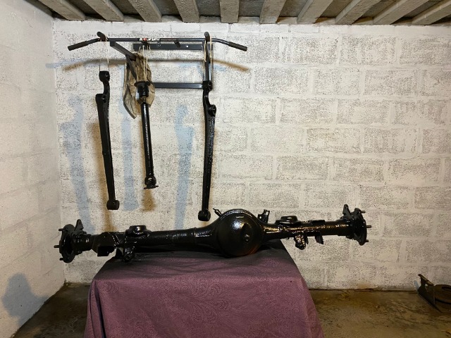

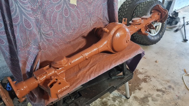

This weekend it was time to give the back half of the Jimny a well-deserved scrub and paint. I've never given it a deep clean/de-rust so I attacked it with a wire wheel (several in fact), painted it up in rust encapsulator from Buzzweld, and then 'WAR' black chassis and underbody paint (also from Buzzweld). Great results - should hopefully keep the rust at bay. Had to do a few patch welds on different bits - body mounts had a few holes/thinning metal and a little hole on the panhard rod housing - nothing too serious.
All cleaned up and primed:
Under the boot and around the fuel tank got wire wheeled and then painted:
Hopefully I'll be able to get it back together one evening in the upcoming week.
