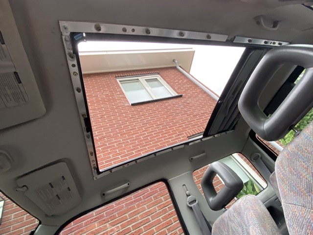

Nice sunroof, best of both worlds

As for the roof, I hope some members here copy the idea. I would, if I didn't have a "Jimny" logoed roof rack.

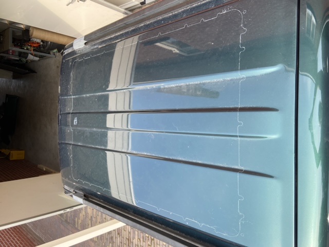

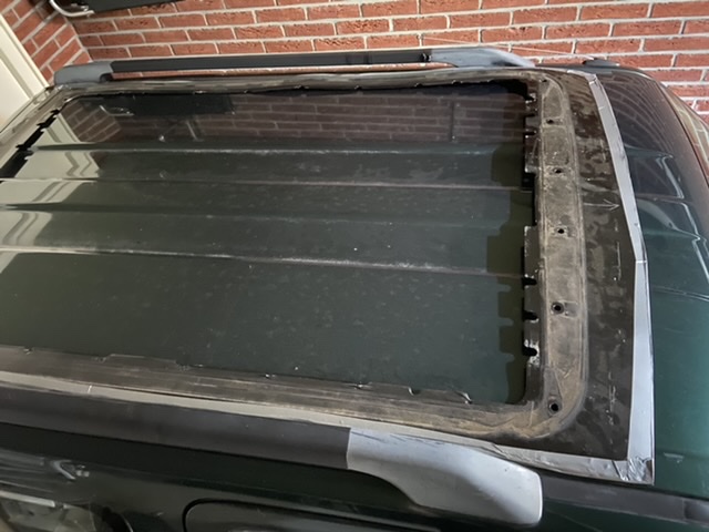

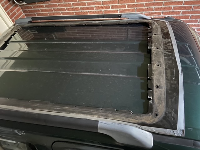

Installation of the sunroof is very simple and basic, just make sure you buy a sunroof with a piece of the old Twingo roof attached, in this way you have the perfect tool to trace a copy on your roof.
