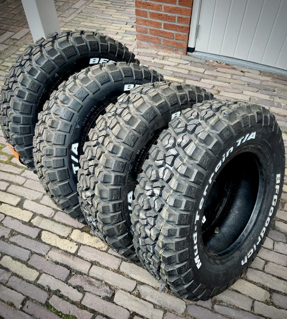

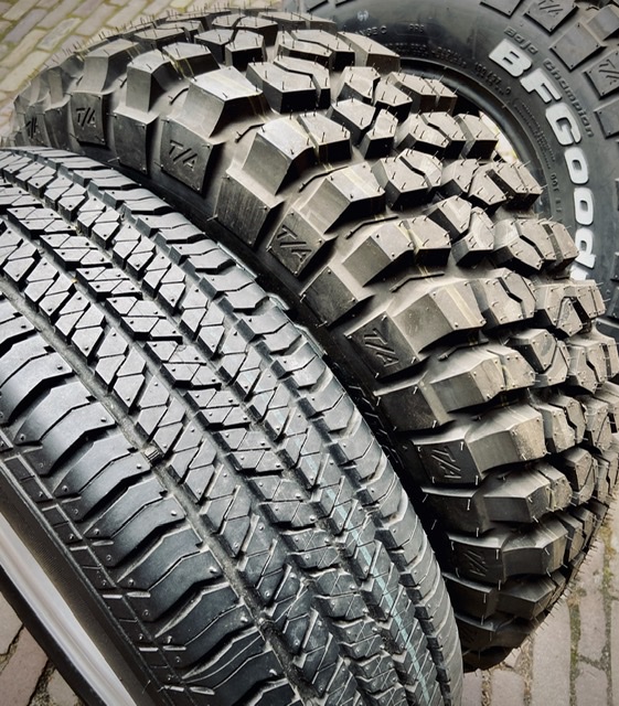

Got the new tires today, hoping to fit them tomorrow. Hope they will fit my 5” wide wheels
Quite the difference
AwesomeX8GGY wrote: I've pinched your idea but adapted it for my needs - here

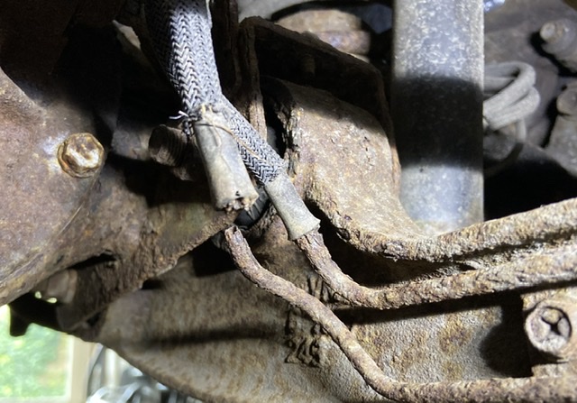

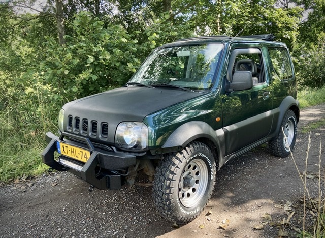

I’m guessing the broken line is from the wheel hub vacuum?
Any issues if I’m going for a ride?
17 Jul 2020 07:23 #225213
by Fossie
Replied by Fossie on topic Green Laning Jimny from The Netherlands
A very common issue..I sleeved mine with a pipe of washer tube and it worked .(temporary fix ...but how long is a a temporary fix.)
But no vacuum no 4x4 , so no issue with driving ....unless you need the 4 wd.
I suppose the best and most sensible is to replace it all because once fixed here it will fail elsewhere.
