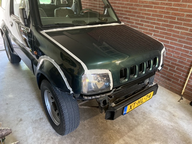

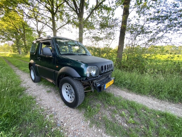

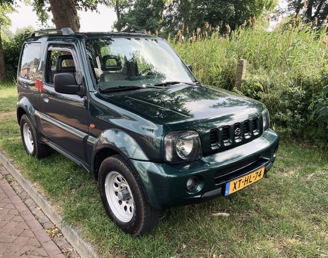

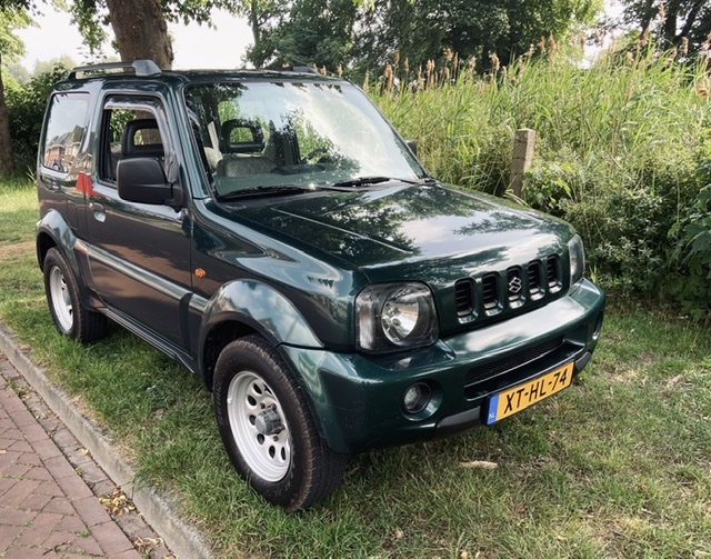

The day of purchase:

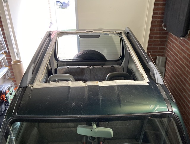

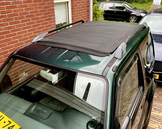

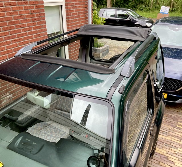

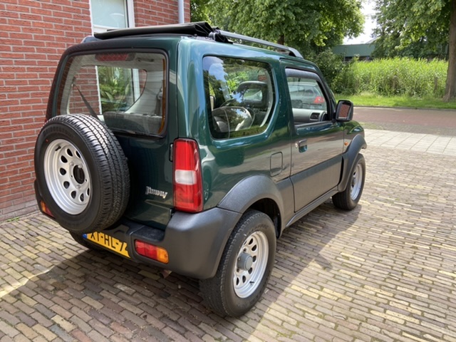

A few days after I’ve installed a Twingo sunroof:

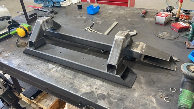

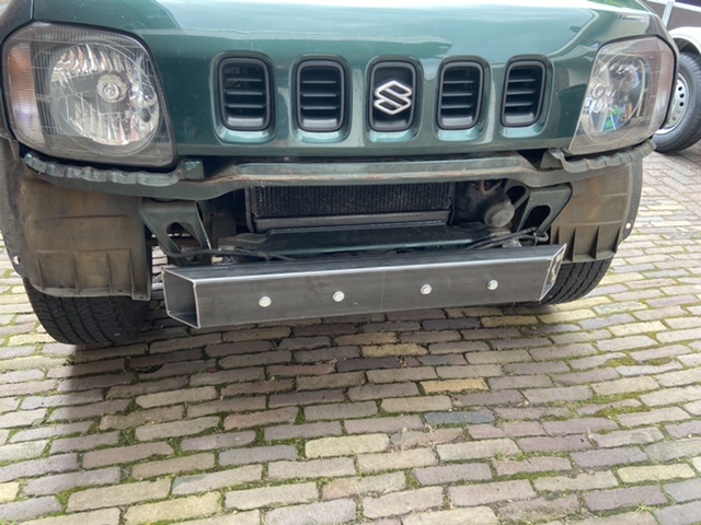

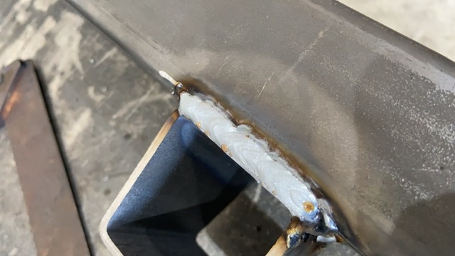

And made a start at the steel front bumper (first welding project):

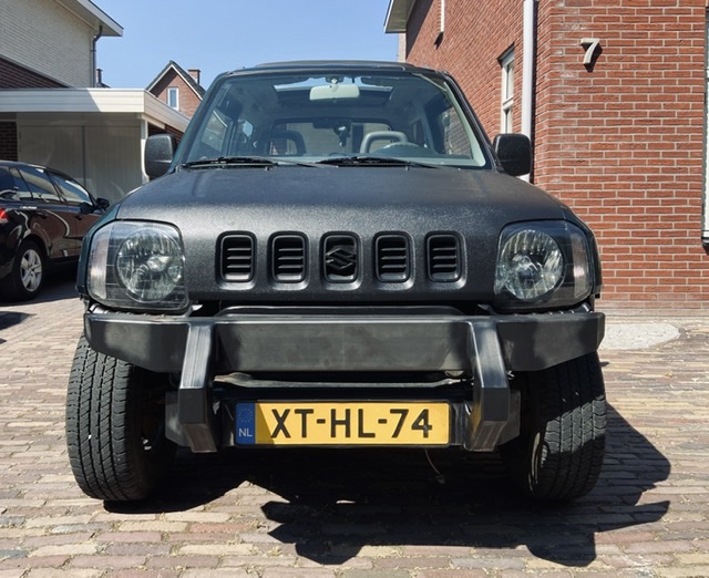

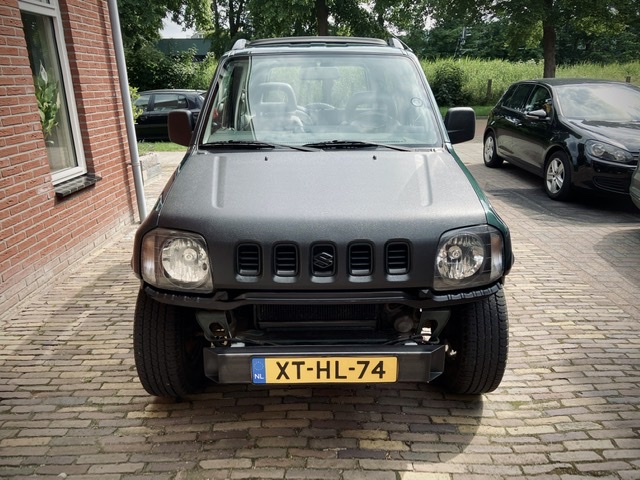

Also painted the plastic pieces and bonnet with bedliner:
And took it for a spin (which is awesome on sunny days with the sunroof open!):

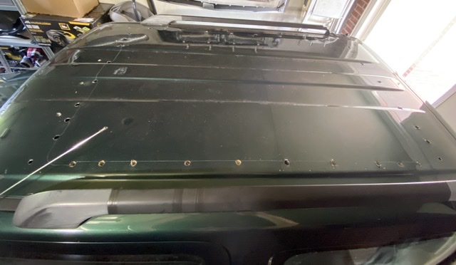

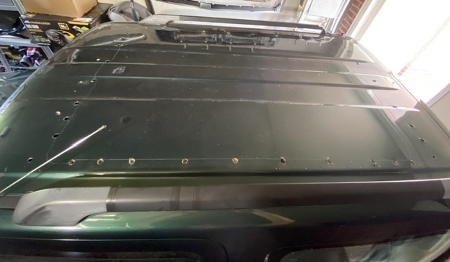

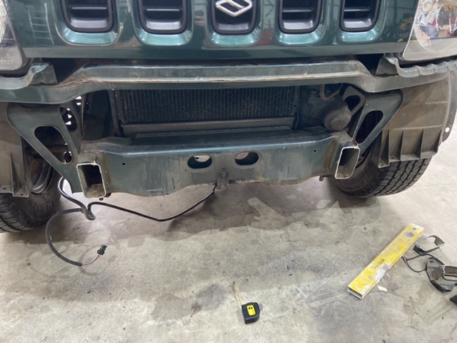

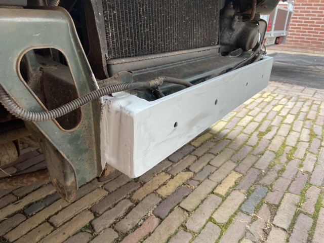

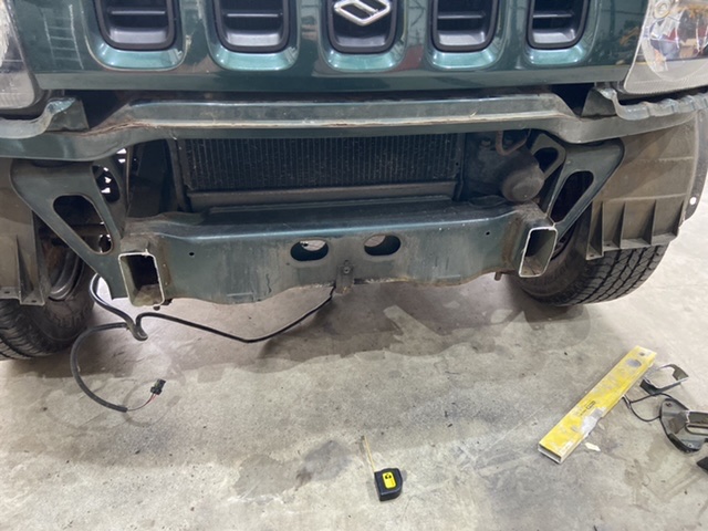

Welcome to the forum. Absolutely love the roof, how have you managed to seal it against the corrugated section of the roof panel?
- JimnyNL
29 Jun 2020 15:06 #224243
by JimnyNL
Replied by JimnyNL on topic Green Laning Jimny from The Netherlands
Thanks for the welcome.
I’ve sealed the roof with an expanding sealant which comes on a roll, we use it in The Netherlands to seal windows in houses (don’t know the English terminology). The rest of the roof is sealed with a flexible car sealant, should be over redundant because these Webasto sunroofs come with build in rubber seals.
I love to drive with the big roof open, gives a convertible feel to the car but keeps the hardtop look.
Only costs €80,- for the second hand Renault Twingo roof

Welcome and what a cool looking Jim that is! Love the roof idea.
Was a bit unsure about your bumper design but now you posted some more pictures I'm more convinced!! Very cool.
