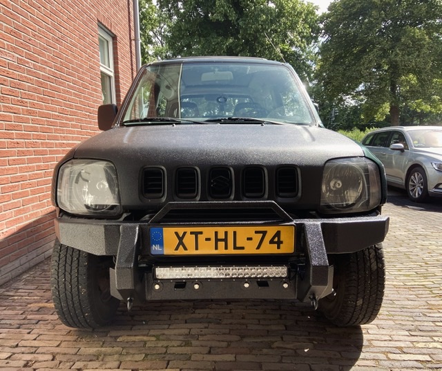

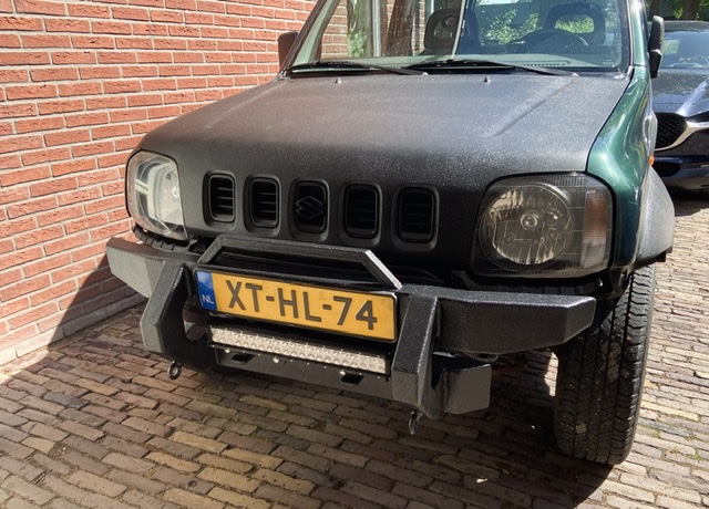

Finished The front bumper with bedliner and mounted It back on today.
I’m very pleased with how it came out.

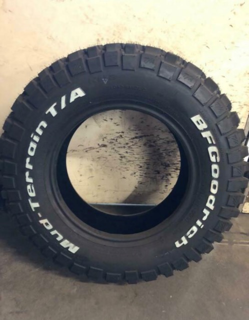

I’ve found some new 215/75/R15 BFG MT’s online today for a very happy price, so I think I will pick them up this week.
