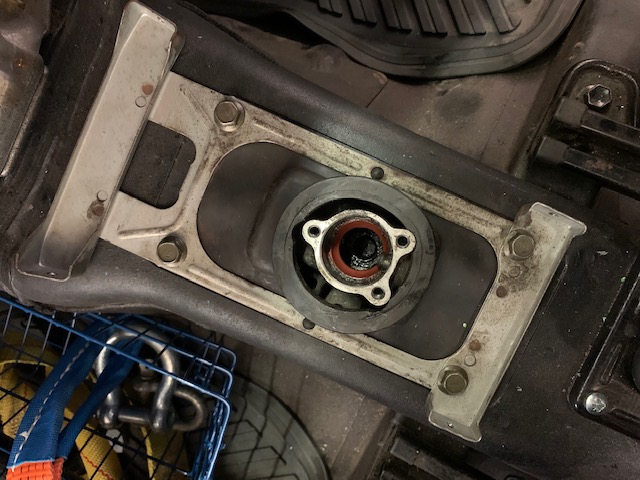

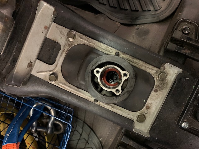

When I got the buggy back from the garage the gearstick was all sloppy, a quick ask on facebook* and someone soon pointed out that the bush often gets dislocated and hides in a corner of the remote box...
So I took it all apart and fingered around inside until I found the bush indeed hiding in a corner, refitted it and reassembled, and all good, the sloppiness had gone

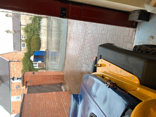

And bolted it up nice and tight - save my feet getting wet!...
