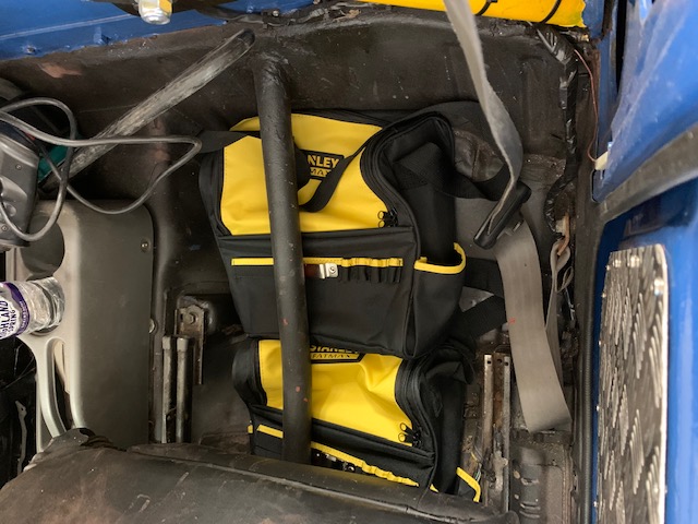

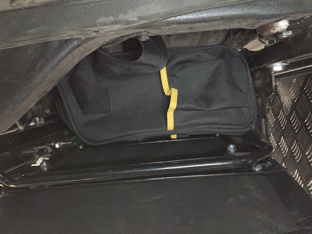

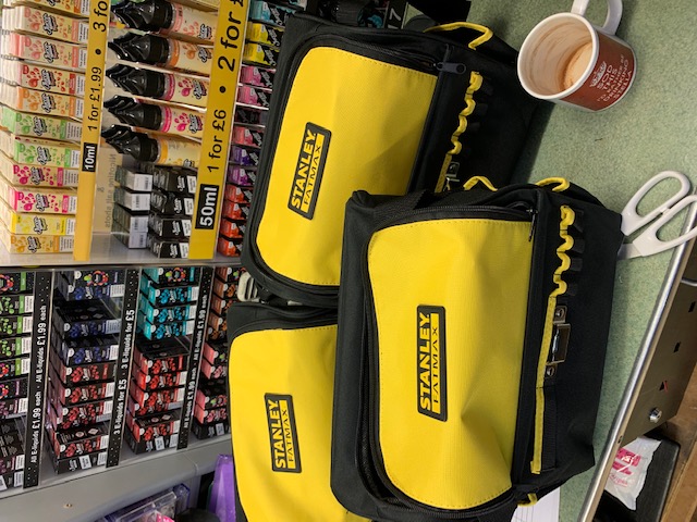

The three Stanley FatMax tool bags I'd ordered from eBay finally showed up...
Two fit neatly under the passenger seat... so that'll be tools and spares...
And one under my driver's seat... unsure yet, butthink that will be hand cleaning, first aid, etc...

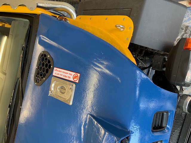

And a sticker also arrived off eBay too...
Kinda relevant I thought?

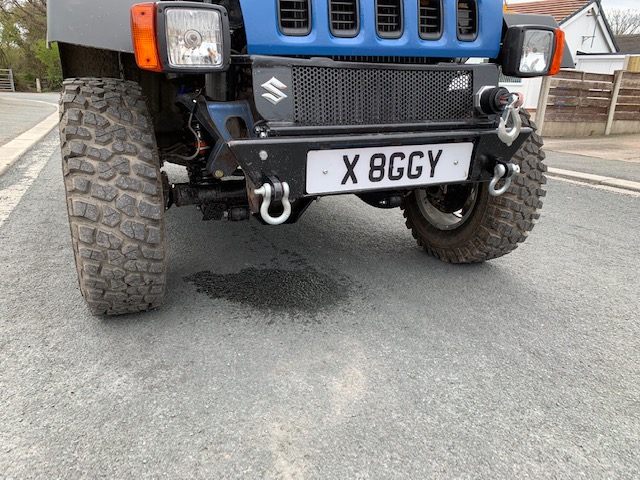

And then, turnng around, the rear locker bit, and I staled the vehicle, and then it wouldn't re-start on the key
I tried and tried re-wiggling the starter cables, but to no avail... and then also noticed -
... that the bottom radiator hose to my new shiny metal pipe was also now leaking...

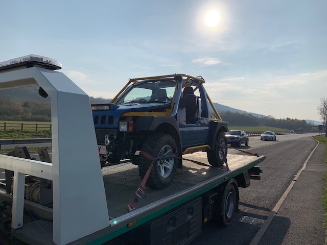

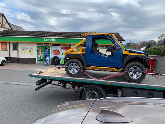

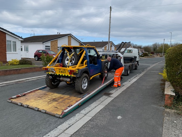

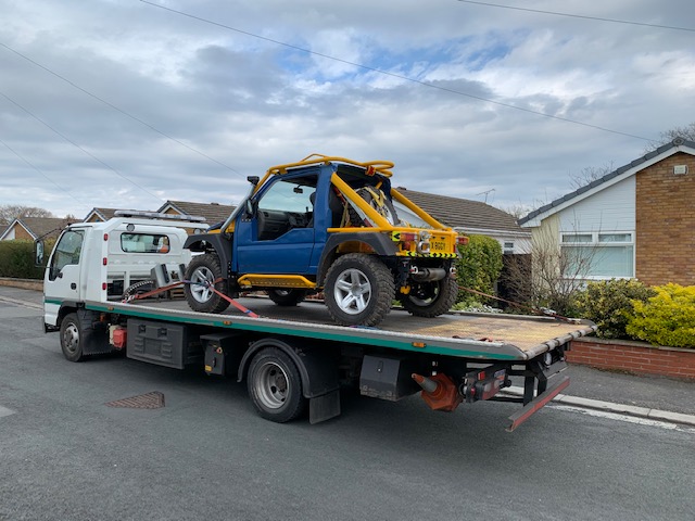

Only one thing for it, call for help... to LNS Recovery who are luckily based at the corner of my road...
The lovely Ken was sent out to the rescue... and soon had The Boogie loaded onto his flatbed...
And then hoisted aloft for the journey...
... Home! Back to the shop / house where he helped me push / guide it back into the garage to await more repairs / finishing off properly

Re the leak on your new bottom hose and pipe.
I replaced my top hose and fitted new stainless steel screw up hose clamps to replace the rusty Suzuki "spring type" hose clamps and it leaked. I refitted several times and it leaked each time. Eventually I refitted the rust "spring type" pipe clamp and it stopped, never to leak again!!
I checked my stainless clamp for sizing and it was correct, I can only assume the size range was too large and distorted the rubber pipe each time I tightened it up. Just in case you can't find a reason, tty the original clamp if you have replaced with jubilee clips.
Good luck fixing it Mike

Replied by DrRobin on topic Re:Re:Re:Dave's la(te)st buggy build...
A change in temperature causing the hose rubber to soften/change diameter might be the problem.
A jubilee clip will keep it's internal diameter constant (except for expansion/contraction), whereas the spring clip will tighten and slacken with changing diameters. It might also respond to vibration.
My pipe had a spring clip shaped indentation in it, I put the [slightly rusty] clip back in the same place, no leaks.

Definately sounds like starter motor/solenoid issues, it can't be battery if it won't start after a decent run. If you have a meter disconnect the solenoid connectors and check that when you turn the key you see some voltage. Also try the spare starter motor.
I don't suppose the leak dripped on either starter motor or solenoid did it?
If it starts, take it round the block, stop it and then try re-starting, repeat until you are sure that the problem is fixed.

Started the day under The Boogie with a piece of sandpaper and some pliers... took the spade connector off the starter motor's solenoid, cleaned the male blade connector on the solenoid with the sandpaper, and gave the female side of the spade connector on the end of the wire a couple of squuezes with the pliers until it refitted snuggly onto the blade and would make a better connection...
Started it, stopped it, started it... repeated a good few times, happy with that... so then I rechecked all the jubilee hose clips and found one slightly loose which had caused the loss of coolant water on the last shakedown trip...
I then filled the radiator / system back up with water and left The Boogie running on the drive whilst I made a cup of tea, went back out to find it up to temperature with no leaks... so I finished my tea...
And then drove it round the block, over all the speed ramps...
Back into the drive, turned it off, restarted it, repeat, repeat...
Happy with that, I went for a longer test run, and then... back to the drive, check the cooling system, all good, stopped, started, repeat, repeat...

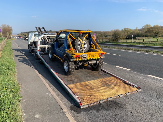

19 Apr 2021 21:02 - 19 Apr 2021 21:04 #234574
Replied by X8GGY on topic Re:Re:Re:Dave's la(te)st buggy build...
SUCESS... or rather not?

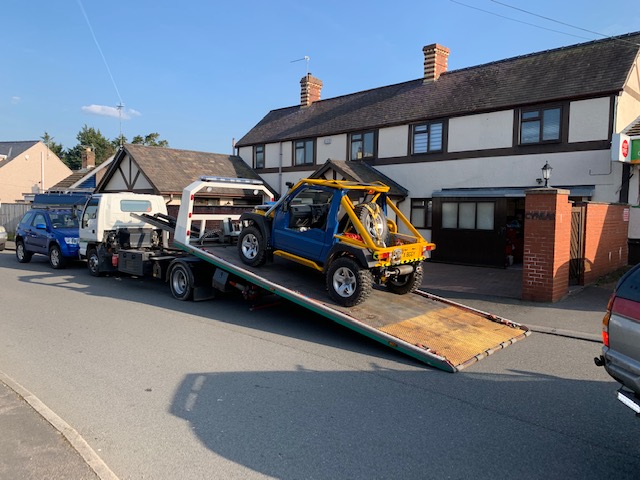

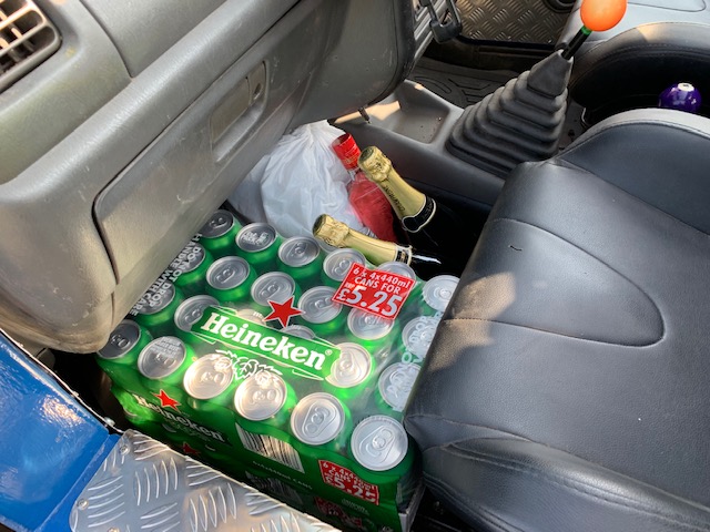

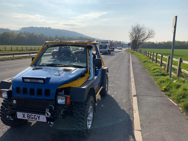

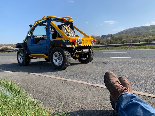

Shakedown Trip #5... We sold out of a couple of Cigarette lines over the weekend, which was hardly worth the trip to Booker Cash & Carry...?
I'll go! I said, any excuse to take a ride in The Boogie...!
A coupl eof cases of Heineken, a couple of bottles of Champagne (Booker sell them as singles, through Londis we'd have to buy a case of six...), the aforementioned cigarettes, and some cases of chocolates behined the passenger seat...
All was going well... I was nearly back home...
When... I thought a loud motorbike was overtaking me? very revvy?... I looked down, ah, no, it's The Boogie, revving it's t*ts off, and running very hot... with the wind noise and a huge smile on my face, zooming along in the outside lane I was oblivious to it... until we started to slow down...
I limped into a layby...
No drive at all... the clutch was fried... I just hope the engine survived?
:ohmy:
Rang the RAC, I couldn't possibly ring my mates at LNS Recovery again could I?...
A nice day to sit in a layby and wait for recovery though?... Many thanks to the Traffic Officer I managed to inadvertently capture in this image! (No, I'm fine, I'm sitting here enjoying the sun, don't bother stopping for a stranded motorist!
An hour later after many humorous posts and replies on facebook,,, I got a message to say the recovery had been passed to a local company...
Please, no...
Ken from LNS Recovery, who picked me up on the same truck last week... Oh the shame!
We had a good laugh about it, and...
... and Ken pulled me onboard... again!
Perhaps one day it might get home under it's own steam?... :lol:
