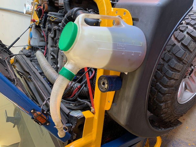

I started by ringing my local friendly garage at the end of our road (who fitted the clutch) and ordered a takeaway...
"Four litres of oil please barman", decanted from a barrel in the back...
And I had a original oil filter ready...

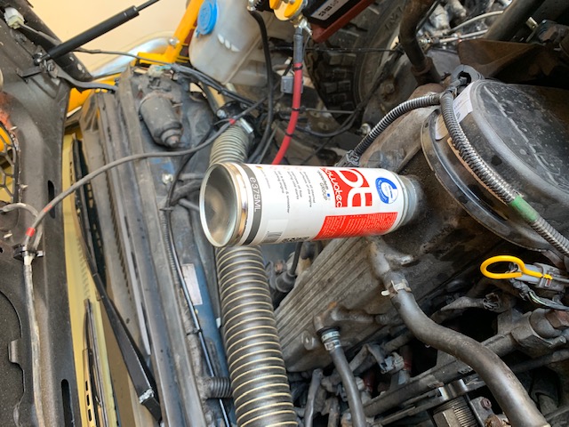

And I also ordered some snake oil, which was delivered later in this thread
Having collected that I put my scruffs on, and as I was sitting on the bottom step of the stairs, putting my boots on, the guys thought they were going for a walk, tails started wagging, so I couldn't let them down...
By the time we got back from our walk, John the garage owner messaged me to say... the snake oil had arrived - high mileage oil additive
With the buggy's engine having done 110,000 miles, I thought anything could help! :lol:
I also opted for SAE 10W-40 as it's what John had in stock in one of the barrels, and is apparently a might thicker than the recommended 10W-30 oil...

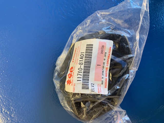

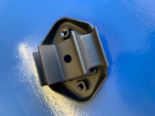

A new gearbox ("engine") mount...

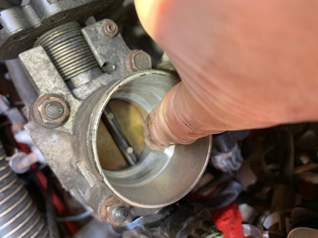

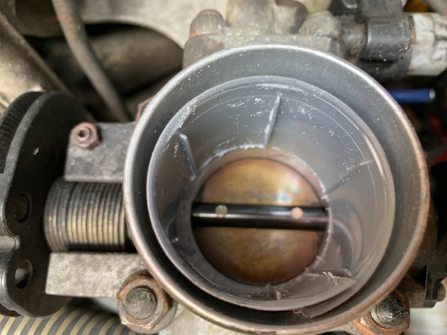

I traced the high idle to the idle control valve by sticking a latex-gloved finger over the input port, and the Boogie idled properly...
I tried and tried - in vain - to get the valve (solenoid) off the manifold, but time was ticking on...
Look away if you don't like bodges!
Are you still there?... A cut up (Dremmel) spray paint can top plugs the input valve for now!!!
It's better, it will suffice for Sunday!

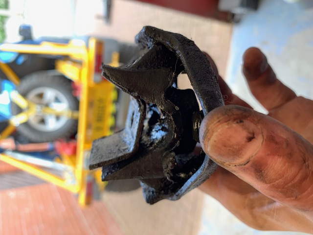

Next the gearbox (engine) mount was swapped out...

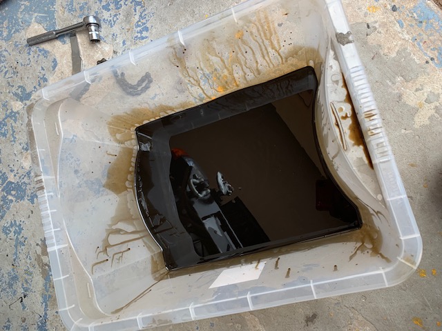

Then the oil was dropped... very, very thin, almost water like?...

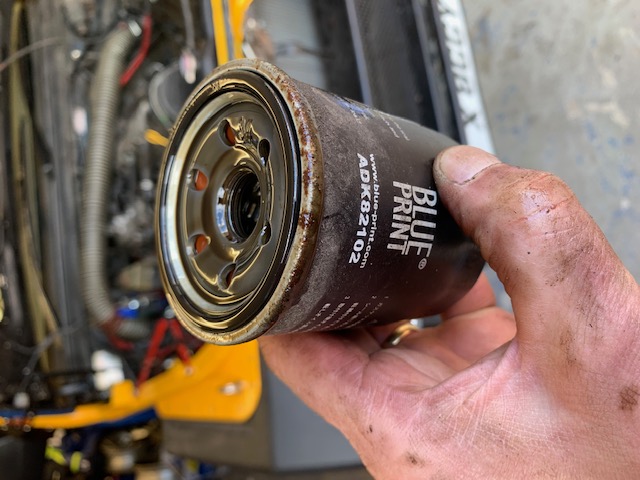

The oil filter looked quite new though?...
And then...

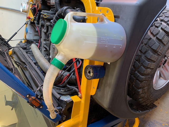

3 litres of fresh oil went in, then the magic additive, and then another 300ml to make the engine full (3.7L)

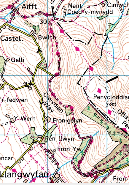

Back to the black square on the maps above then, ad rising up from "Aifft" on the first BOAT -

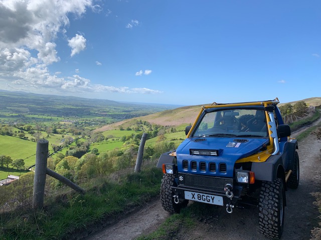

... from the valley floor...
Through the gate at the top of the ByWay (BOAT) and then...

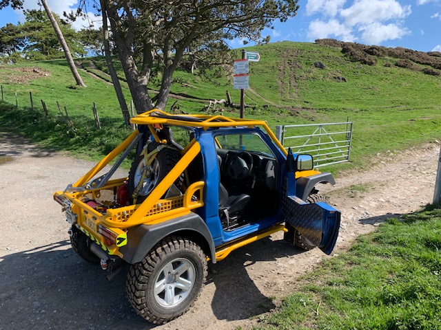

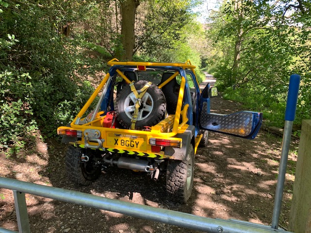

Up to the parking area at the top where I broke down (coolant pipe rusted through) and called for help from friends at the local recovery service (also at the end of my road!), but this time I'm through the gate and onto the second long BOAT, shown on the map -

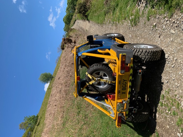

Which snakes along the edge of the Clwyd Valley...
A glorious day to be out in the countryside!

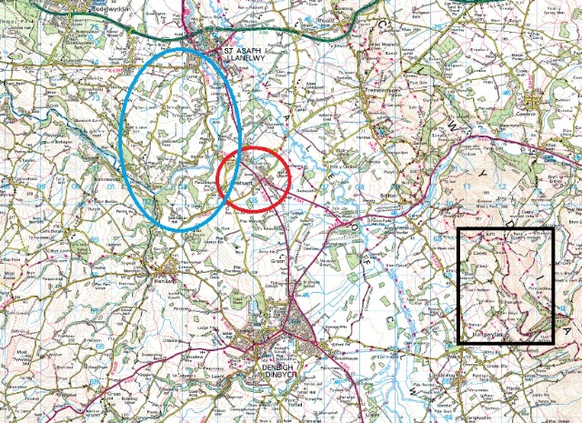

Back to the map again, the lane was in the big black rectangle... coming back through Trefnant in the red circle, I'd queued there earlier in the day passing south through it... coming back, all roads were tail-backed due to tree surgeons at work, so I swung round and went cross country winding down all the country lanes in the blue circle to get back home to St. Asaph, avoiding all the tailbacks...

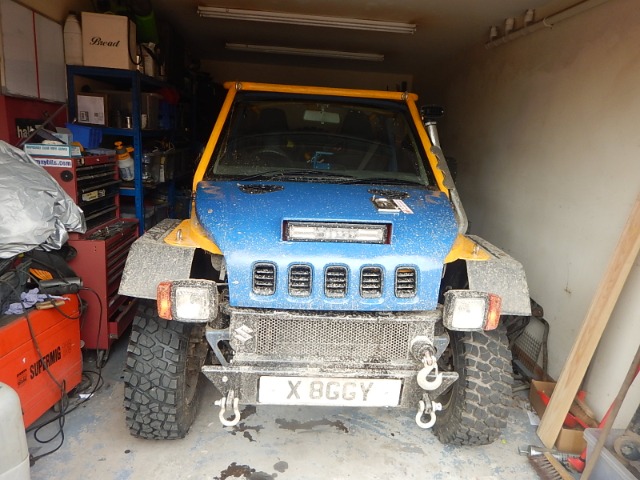

NOT a great day, more details here in my blog -
jimnybuggy.com/2021/05/23/first-trip-with-the-group/
But The Boogie has been locked in the garage for being naughty once again -
Gathering my thoughts and considering my options...
