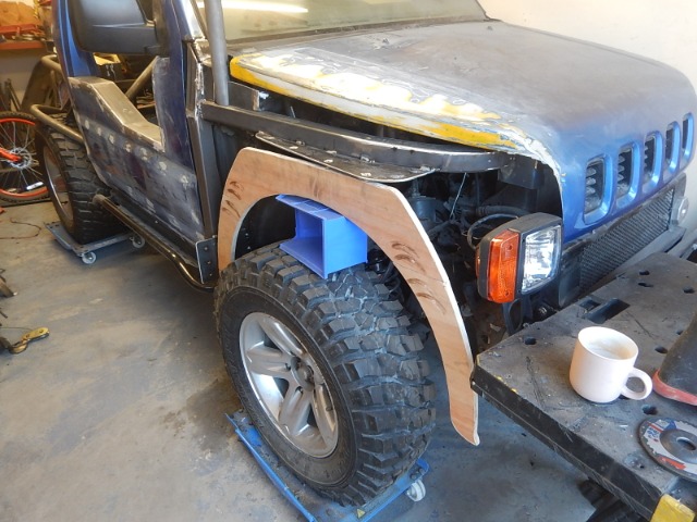

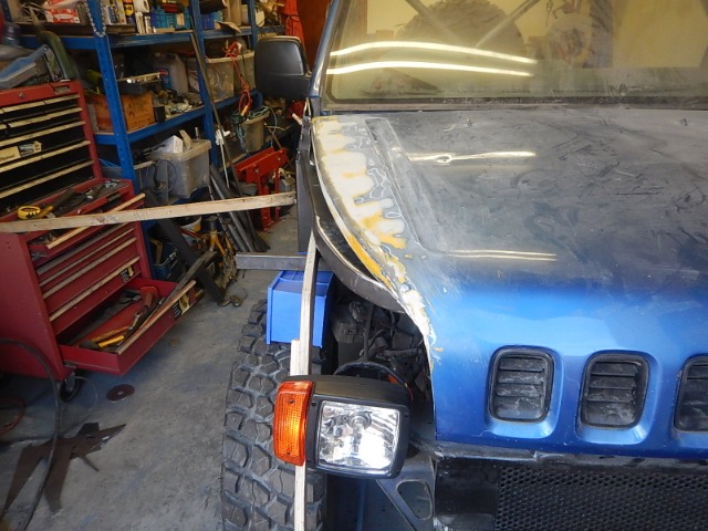

One of the things I'd thought about... so I remounted the headlight to work things around...

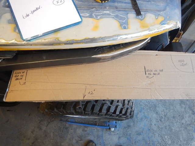

I then spent some considerable time measuring and re-measuring, and cutting up some box section...

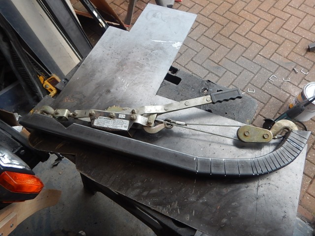

How do you make box section curves?
All welded up!...
Lovely!

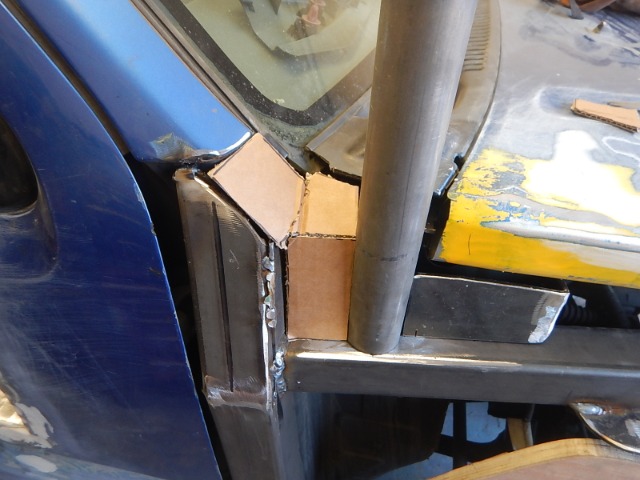

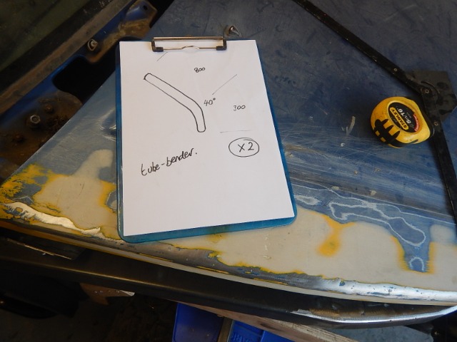

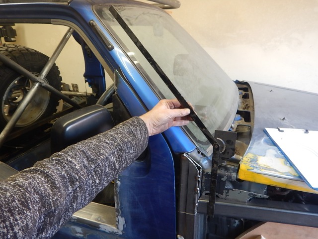

Out comes the angle-o'meter to work out the a-pillar tubes...
To make another order for Tom "tube-bender" on eBay...

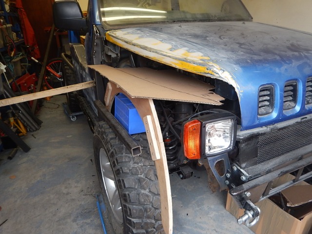

Some more CAD (Cardboard Aided Design) Keithy

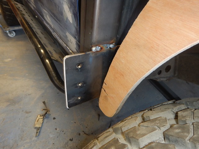

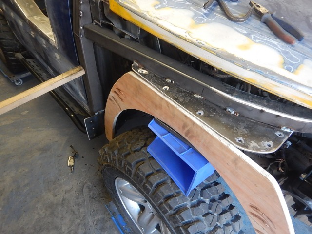

To make upper mounts for the front lorry wheel arches...
And weld them to the new inner arch to slam panel bent box bits...
Note also the lower mount at sill level on the door post that has also been welded up and finished...

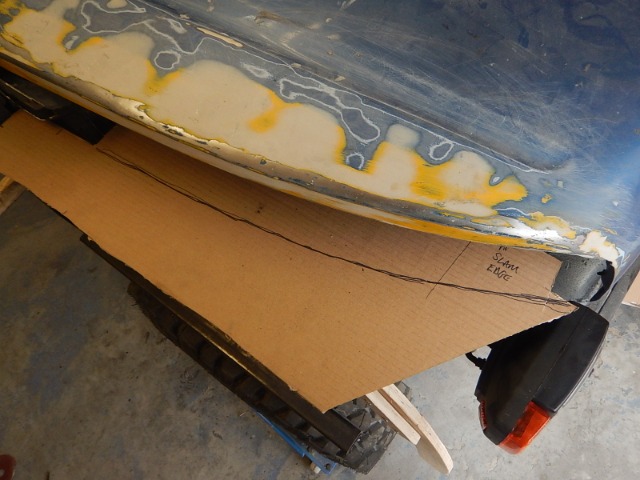

More "CAD"...

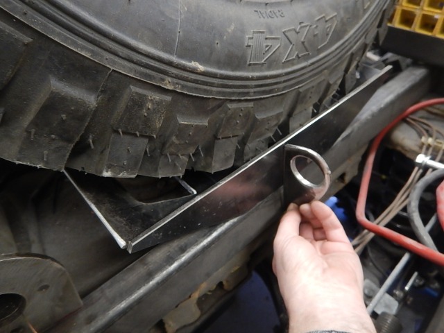

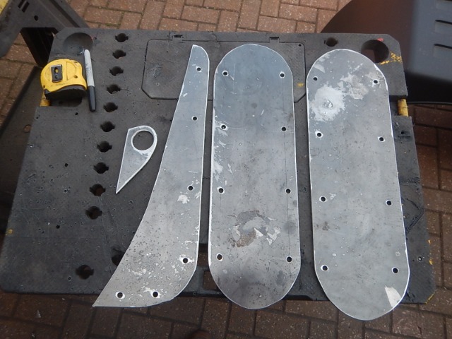

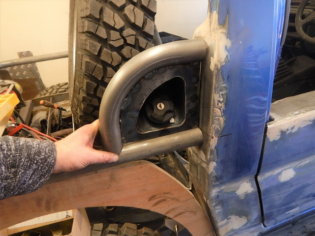

Made the other front wheel arch bracket, and two for the back wheel arches, and a loop for the spare wheel strap to attach to...
Like that to match the front ones...
Spare Wheel strap will clip on to this...

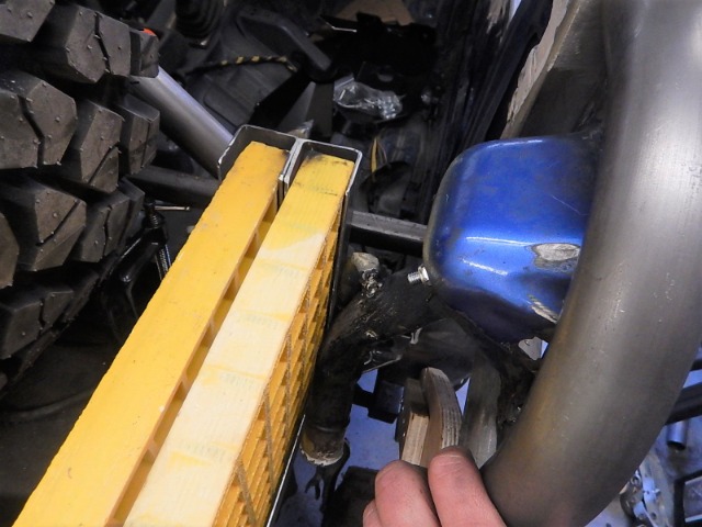

I then clamped the two fuel pipes and took the old filler assembly off, reworked it all, and ended up with this
I had to adjust the filler and return tubes a bit so they didn't foul on the waffle boards, I'll add some plate to the corner of the outside bottom right waffle mount to stop any rubbing...

How much of a little lay down are you expecting to have if you're caging the filler cap? That's my favourite bit so far!

:lol: Thanks... yes, the filler cap had to match ? I was just lucky there was already a locking petrol cap under the flap... saved me buying one!
