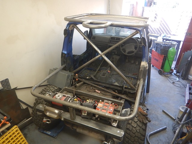

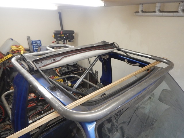

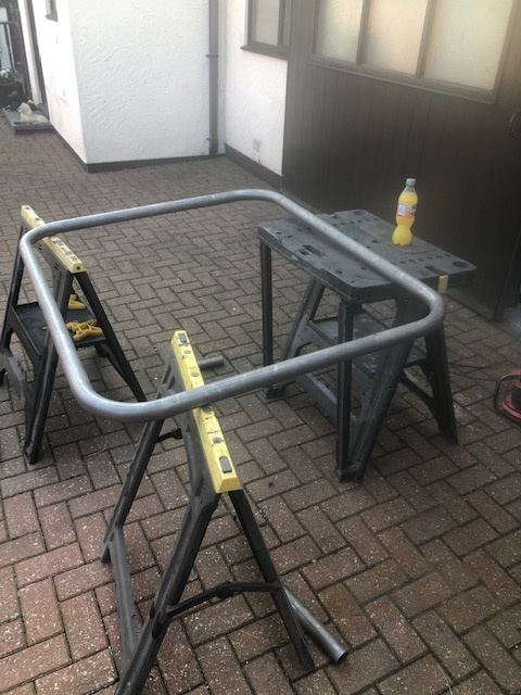

I measured and cut the two rollbar hoops I'd had bent up, and then joined them together with some smaller diameter seamless tube inserts...
I then added the smaller 180 degree bend to the rear of it, and having cut and fish-mouthed the two stubs that come throught the Jimny's body rear hoop I placed the loop in place...
Looks a bit like a halo at the moment until all the other tubes are added! :lol:
You get the idea now? The loop is for tree scraping, to push branches out of the way when greenlaning, and the little rear loop is for...

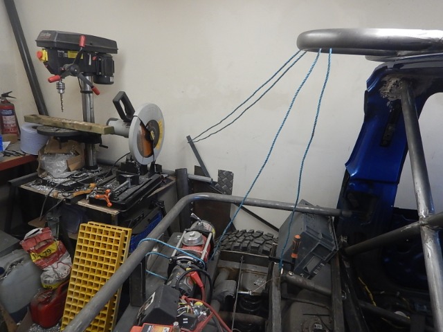

... a mock-up with some blue builder's rope... so the rope that runs down in the tube under the passenger's (Alan's!) seat is static in the tube, a loop can be pulled out of the 'front' of the winch and up through the little loop on the back of the roofline, and a snatch block can be used in that loop of winch rope to either steady the buggy, or self-right it in the even of a "little lie-down" ! :ohmy: :lol: So as the winch spools in the rope is pulled back through the koop...

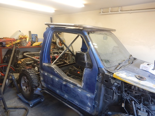

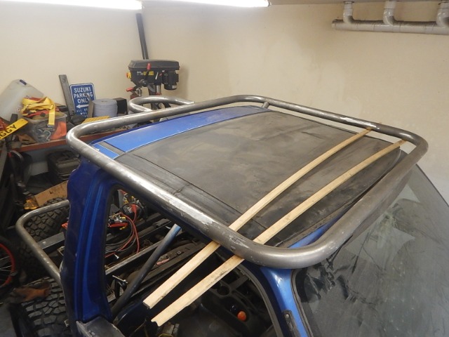

Pulled the front soft-top section back to test it fits nicely inside the roofline tree scraper and roof protection bars, and to bend the front mounts to suit... but time was ticking on by now, and the dogs needed a walk...

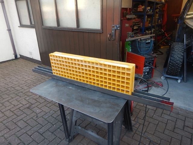

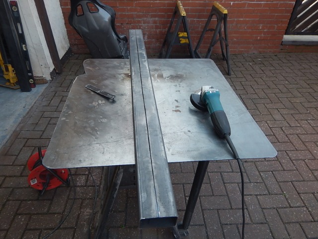

So I marked a line down the centre of some 4"x2" rectangular box section...
And cut it in half! You can see where this is going!

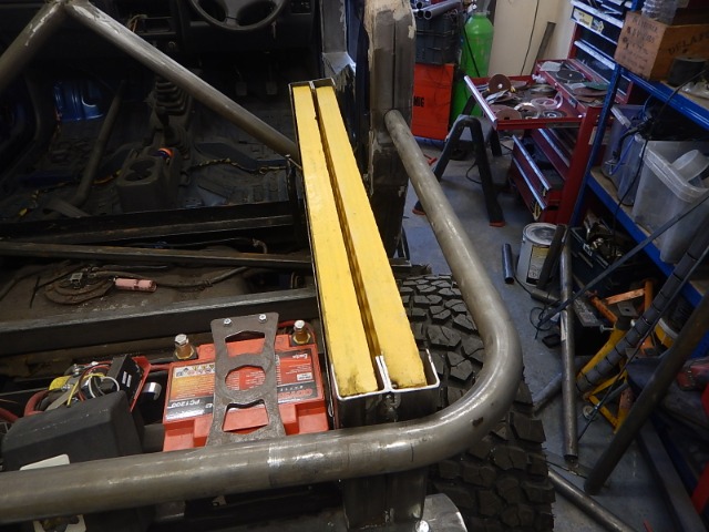

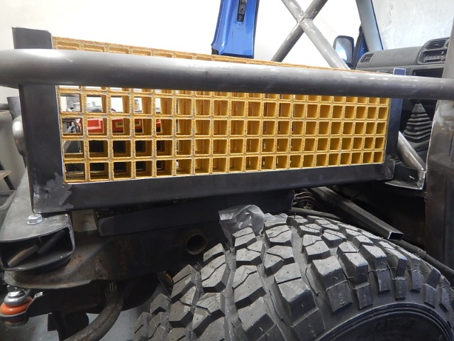

Side of the rear bed / waffle board holder!
But then our youngest daughter appeared, with the dogs... her daily exercise trip in lockdown Britain, so I had another hour to play in my own self-isolation!...
