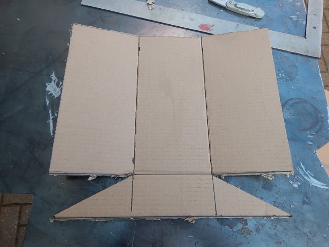

A good day at it today!...

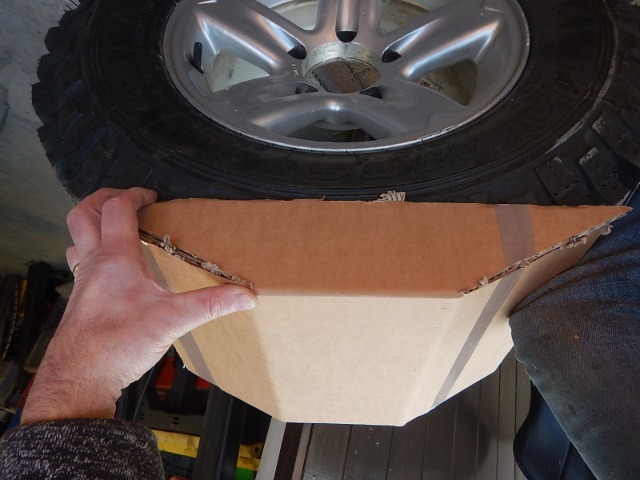

Started with the CAD (Keithy
) Cardboard Aided Design...
There's a clue!

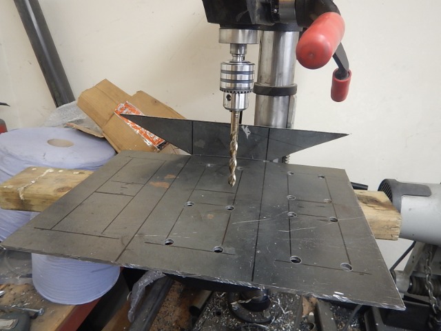

"Boring" day... lotsa holes!

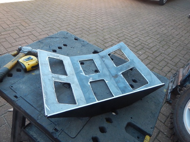

Cut, sand, bend... "can you tell what is it yet?"

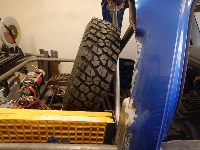

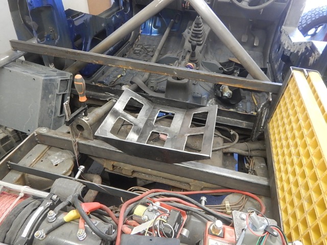

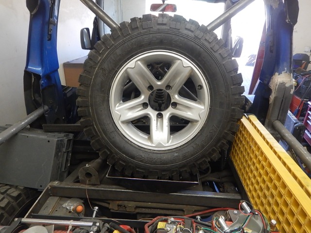

Spare wheel mount with holes for drainage / keep the weight down...
It fits! With room for a bigger one later?! :lol:

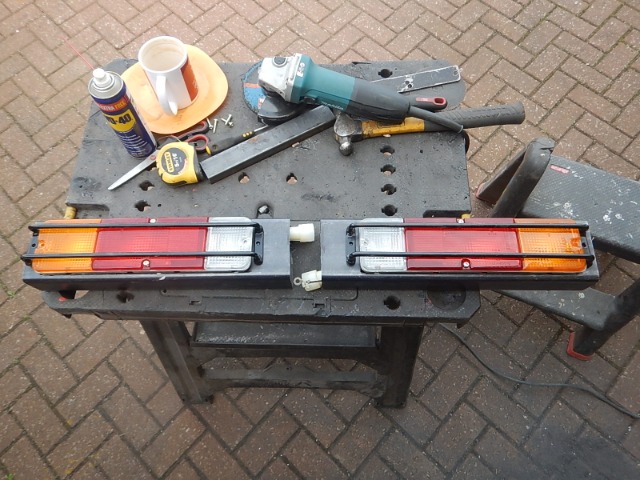

Sits nice to maximise rear view...

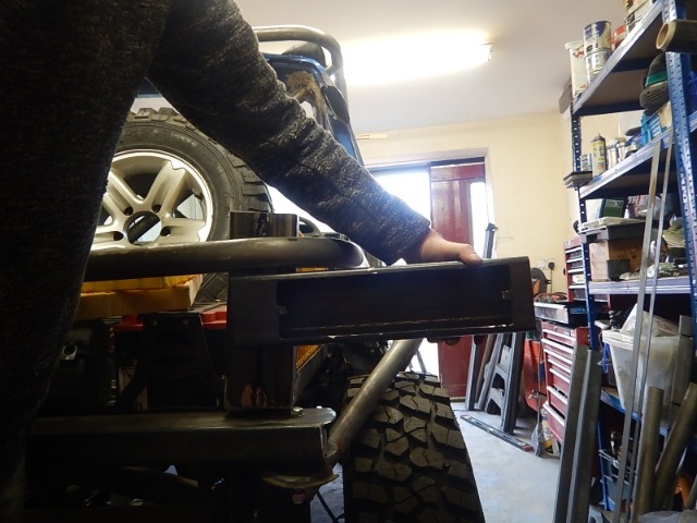

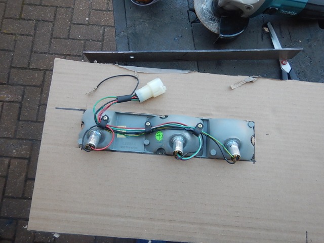

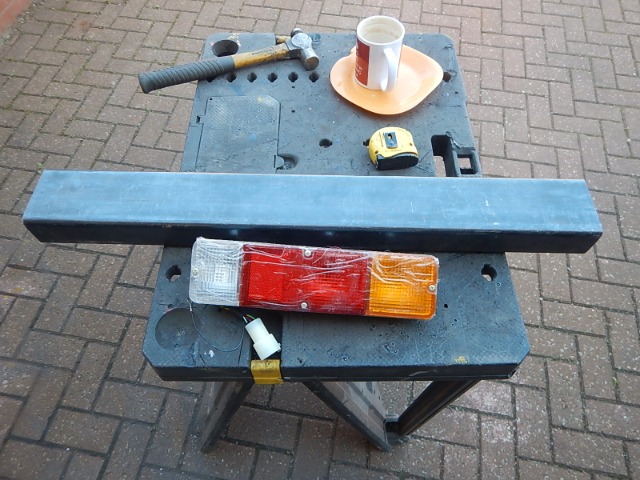

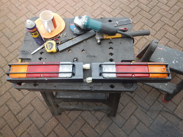

Rectangular section and am SJ/Samurai rear light...

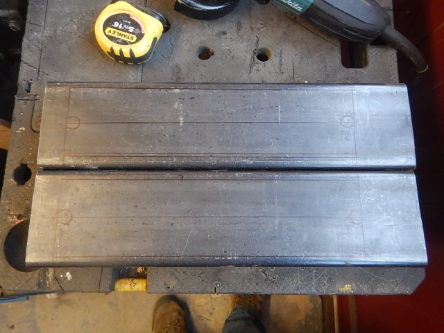

More "CAD"
Mark, drill, cut, sand...
Insert lights, add guards (eBay)
They'll go something like this...

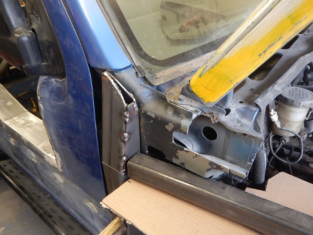

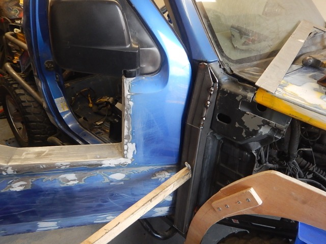

60x60mm box section, tickled for ages with the angle grinder...
I had to cut some of the inside of the box away to get around the hinges, and so that the half-door tucks neaty behind it, with a reasonable panel gap (for a buggy!)

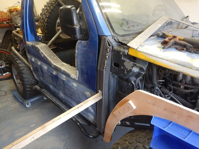

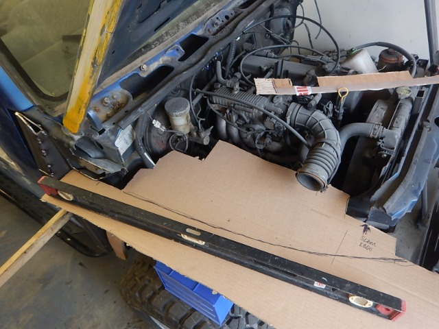

More CAD, working out the line of the bonnet to put 50x50mm box from the new door edge to the bonnet slam panel...
From the side, planning and making sure everything will fit together later...

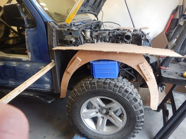

Mock-up with some slightly smaller box offcut that was lying around... Sp the two box sections will meet here, and the tube down from the roofline halo hoop will run down the windscreen's a-pillar and land on the box section with a strengthening gusset welded to (what's left of) the inner wing...
More "CAD"

16 Apr 2020 16:53 #221135

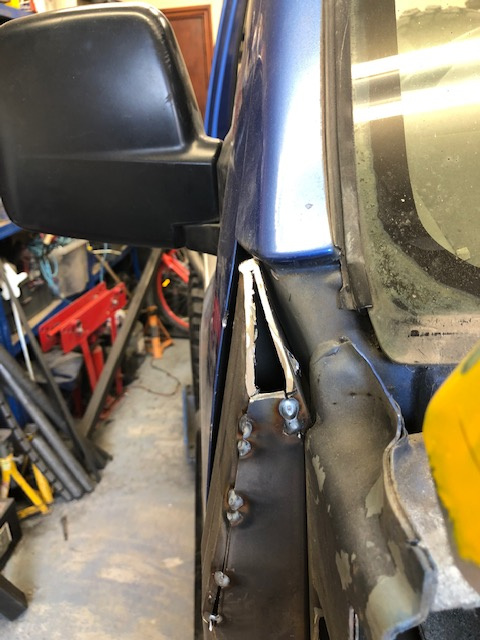

That last photo (above) -
... has been bugging me, I've been staring at my iPad in the shop planning Sunday's work in my mind, and it looks like all the angles are wrong...
But -
... from the other angle it is right, it just needs a bit of a fillet to fill the gap where you could put your finger in between the door and the door post...
But -
