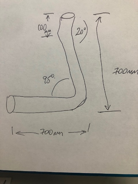

Replied by jackonlyjack on topic Dave's la(te)st buggy build...
Manifold down pipe
Dave do you always submit sketches like these to tube-bender
If he works from sketches,this will suit me fine
- X8GGY
01 May 2020 05:50 - 01 May 2020 05:51 #221720
Nope

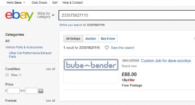

Sort of... if you look at his listings, he lists a number of different size hoops, and gives a maximum size, so it's just a matter of picking the one closest to what you want and then giving him the custom dimensions you want, so the distance across the legs of the hoop, the height of the hoop and the material you want it bent out of (he lists 4 different sizes of CDS tube for instance)... that's how I specified the two top hoops to well together into the "halo hoop" around the roofline, and used a sleeve in the joints...
And then he lists different angles of bends, so again I pick the closest to what I want and again specify the material, the angle of the bend, and the length beyond the bends either way..
Here's a basic hoop for example, then see his other items...
Hope that helps...
