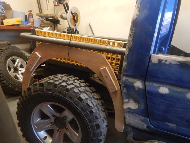

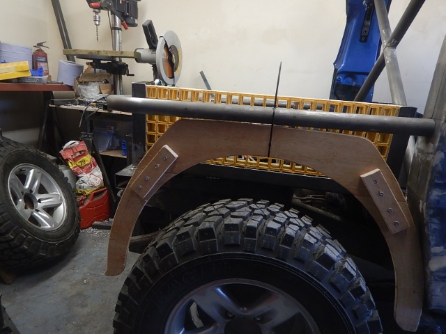

A couple of hours off this afternoon, so not enough time to get my scruffs on
But I thought of something I did need to do...
Those lorry arches* are big and cumbersome to get in and out of the garage to try and test fit them, so I needed some plywood templates!
*don't worry the side with the white logo and pin stripes is getting cut off!!
Et Voila!
Hard to get a photo as the garage wall and racking is in the way, but it looks to be a good fit, just under the tube loop of the rear bed

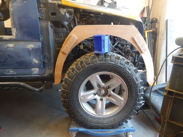

And the front...
That'll work nicely too!

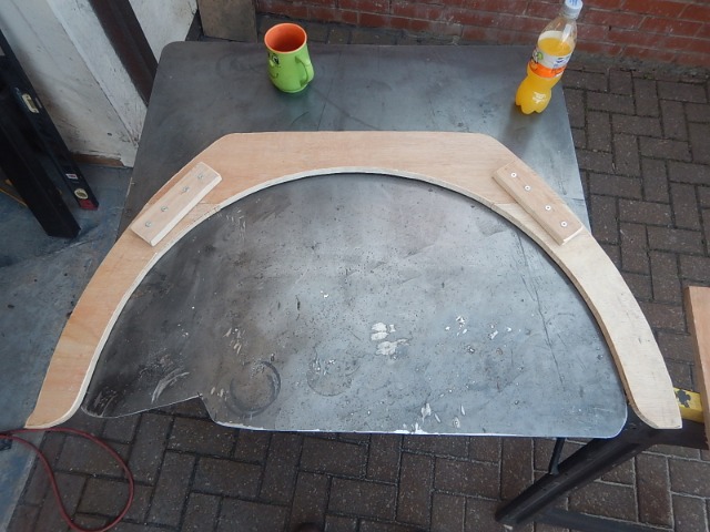

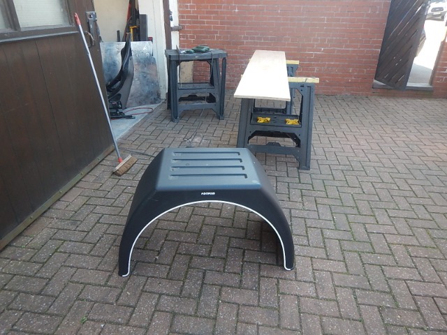

Note! Don't worry... they'll be fair bit of trimming to them yet! As shown earlier in the build thread -
