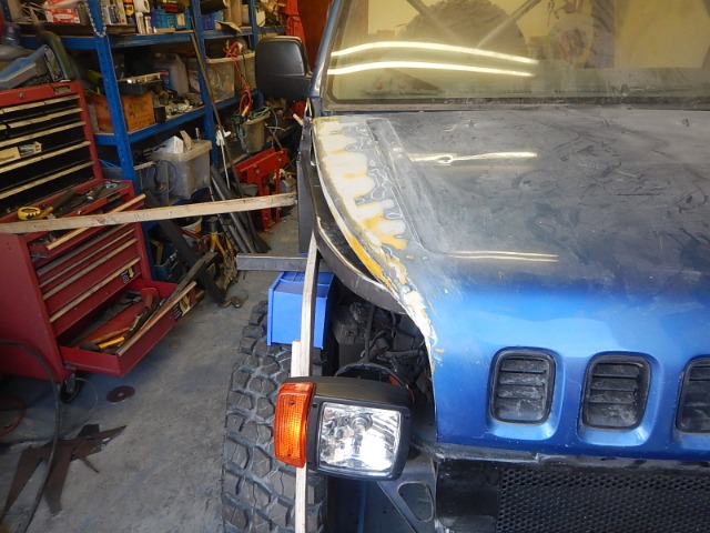

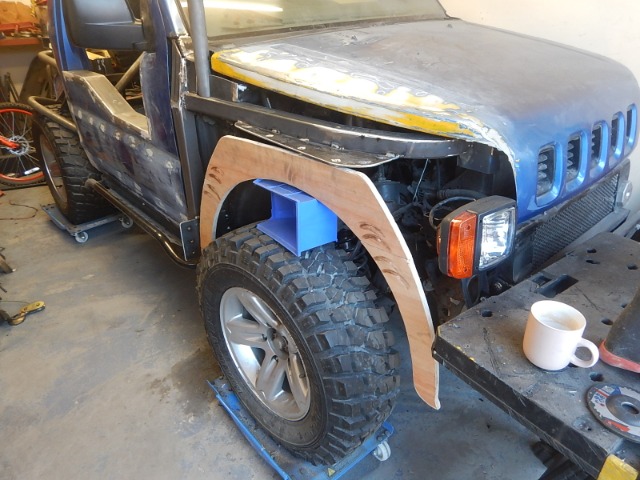

One of the things I'd thought about... so I remounted the headlight to work things around...
I then spent some considerable time measuring and re-measuring, and cutting up some box section...

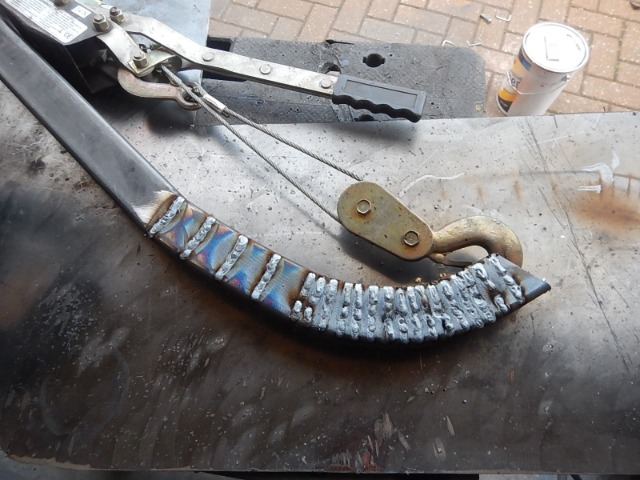

How do you make box section curves?
All welded up!...
Lovely!

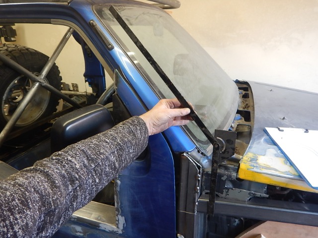

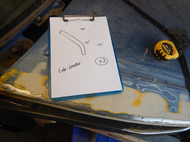

Out comes the angle-o'meter to work out the a-pillar tubes...
To make another order for Tom "tube-bender" on eBay...

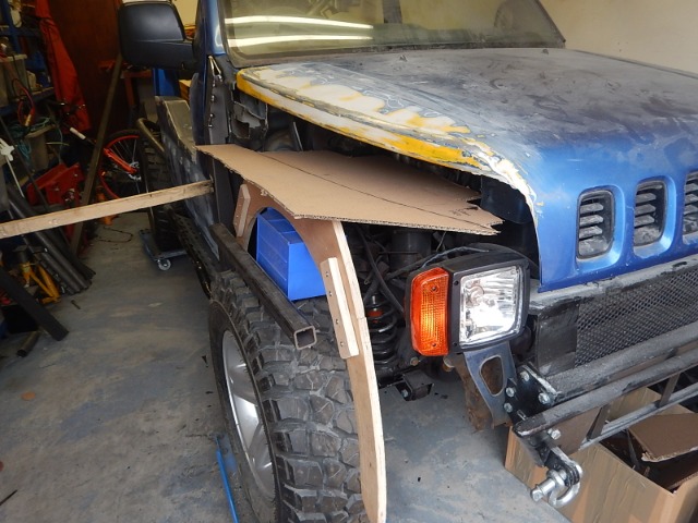

Some more CAD (Cardboard Aided Design) Keithy

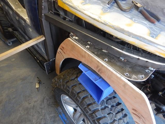

To make upper mounts for the front lorry wheel arches...

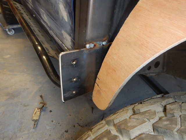

And weld them to the new inner arch to slam panel bent box bits...
Note also the lower mount at sill level on the door post that has also been welded up and finished...

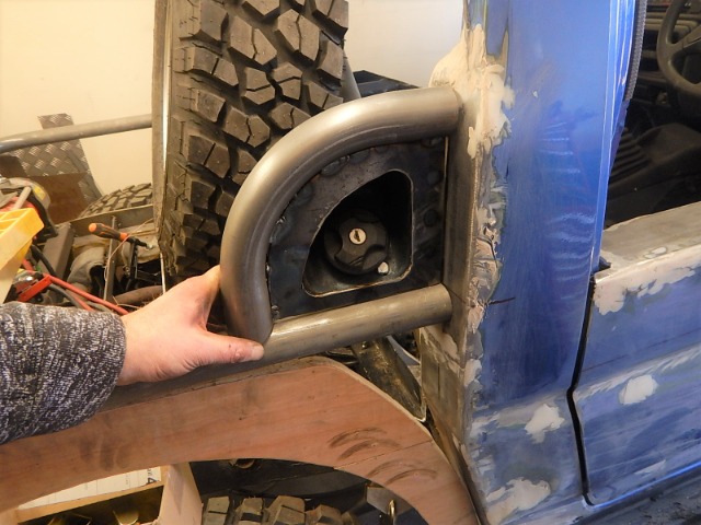

Made the other front wheel arch bracket, and two for the back wheel arches, and a loop for the spare wheel strap to attach to...
Like that to match the front ones...
Spare Wheel strap will clip on to this...
