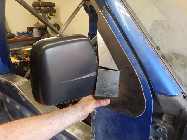

Shape it to protect the mirror - particularly the hinge, which is prone to "trees jumping out in front of it" :lol:
With mirror folded in...

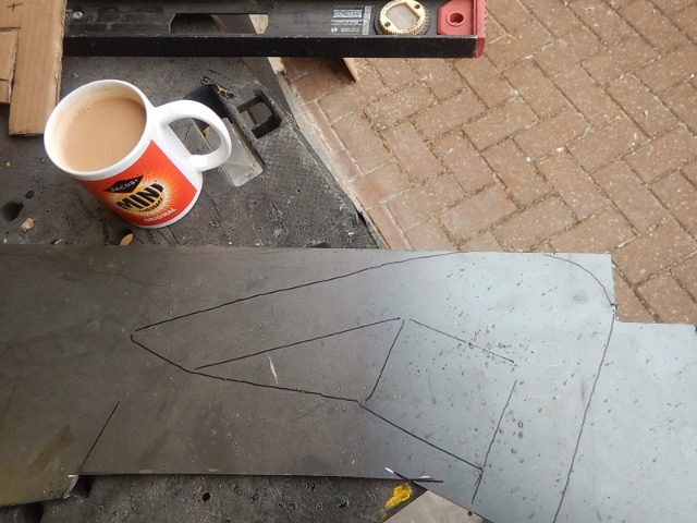

Mark out on steel plate...

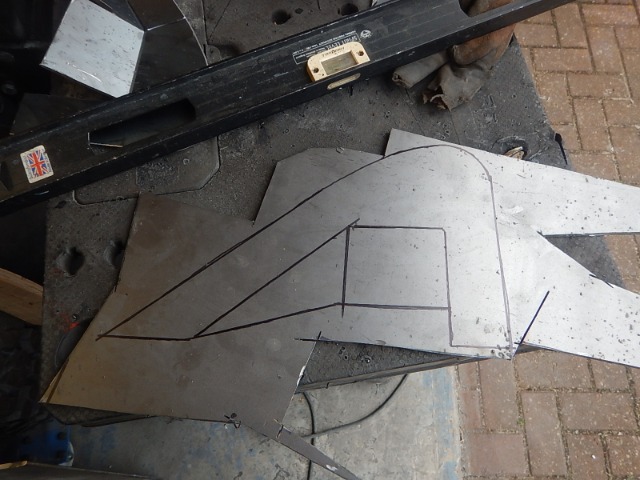

Cut and bend...
Steel version, mirror out..
Mirror in...
YUP, happy with that, so...
Mark out the other one, making good use of one of those awkward looking pieces you keep just-in-case...
And... a matching pair of mirror guards!
They just need welding up, grinding / sanding back and holes drilling to mount them with Riv-Nuts to the doors...
Cut and bend...
Mirror in...
